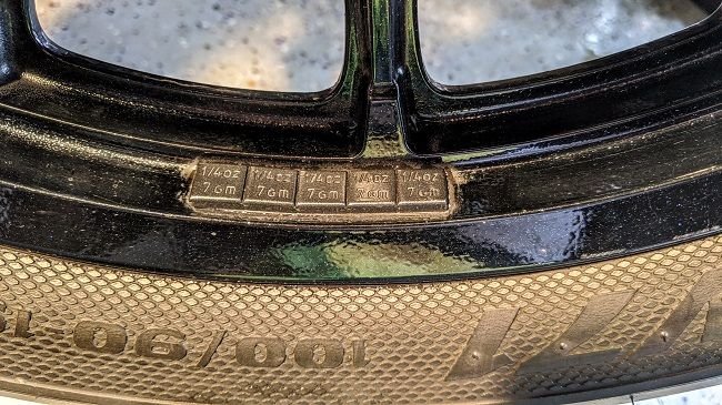

Front wheel. 35 grams, all on one side.

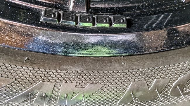

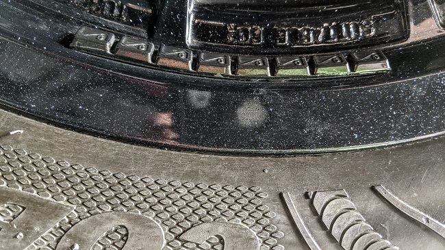

Rear wheel. 40 grams on pulley side, 25 on brake side. 65 grams total.
