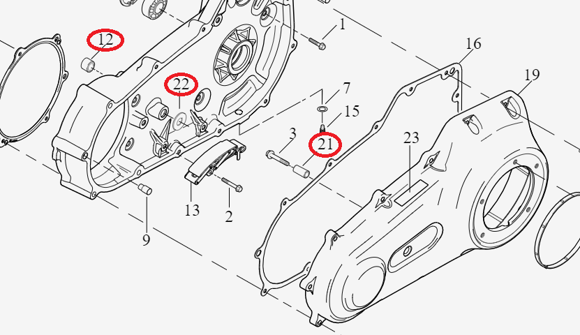

I have an 06 street bob. It came with mid controls when new but over the years one of the previous owners swapped them out for forwards and removed the shaft going through the primary. I prefer mids and want to tackle getting them back on the bike. I have the footpegs and controls. Also purchased the shaft that goes through the trans. Now I’m seeing that there’s a bushing and a seal That go on that shaft. Is the shifter shaft that is attached to the transmission itself the same regardless of forward or mid? Also is there any other parts I’m not finding here? I’ve read through a few posts of the switch and most seem to include various seals and o rings that people change for maintenance to purposes. But I just want to make sure I’m not missing anything extremely important to get the shaft back through the primary.

Here's what I found at MoCo's SIP:
12 34982-02 BUSHING FXD35, FXDBI, FXDCI, FXDI, FXDLI
21 60798-06 SLEEVE, primary cover (Domestic, California, & HDI) ALL
22 63869-06 GASKET FXD35, FXDBI, FXDCI, FXDI, FXDLI

thank you for that! I believe #21 shouldn’t be needed as My bike had mids at one point I doubt they removed the sleeve from the primary.
