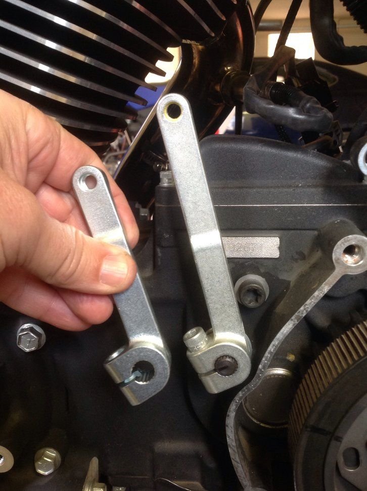

It's because you have the mid control lever on the tranny, the forward control lever is taller and it changes the angle of the rod. Lots of guys do the swap only 1/2 way and leave the old lever on there not realizing it's different and won't work correctly.

Ah, here you go a pic of the two different levers from the link @cubby89 posted above.

I understand that, but the only difference THAT shaft, which sits BETWEEN the engine and inner primary, would make is in the angle of the shift rod, and a miniscule amount of turn toward the front on the shaft that is attached to. It's the other shaft that goes through the THROUGH the inner and outer primary, with NOTHING attached to it, that I'm having issues with, though it should NOT be affecting THIS shaft/arm, however it DOES. If that OTHER shaft, which is NOT attached to ANYTHING, but goes through the inner and outer primary, when it's tilted toward the front, neutral is slightly difficult to get into, but when it's tilted back, it's hard to get into 1st gear, and always stops at neutral.
