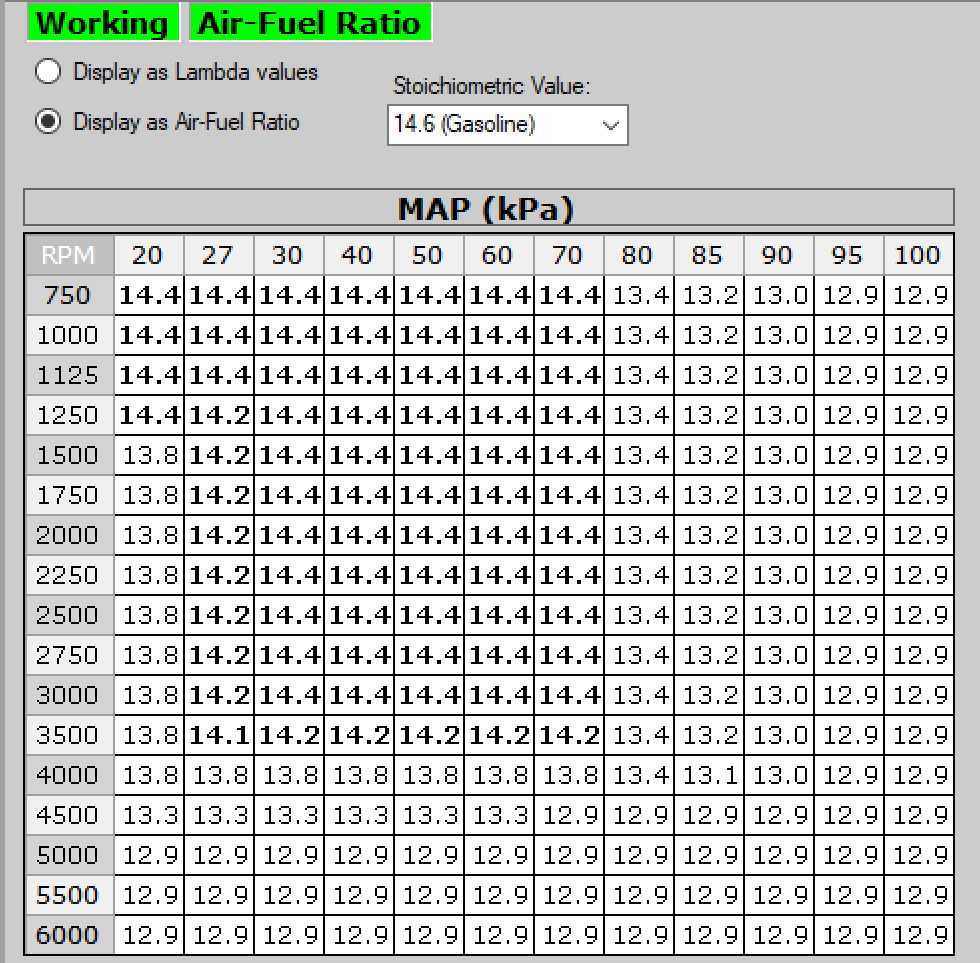

Hey y'all,
I've got a 2015 FXDB Street Bob, with a San Diego Customs air intake and a Thunderheader 2-1 exhaust. I've been using a Screaming Eagle Super Tuner Pro for the refinement. I've been having some issues with popping on the bike. After everything i've researched in the forums i've amounted it up to the AFR or Decel Enleanment either running too rich or too lean. Mostly the popping i've been having is when i shift (let off throttle, pull in clutch at about 2-2500rpms), and also decelerating at about the same.
Do any of you guys have a map that you use to get rid of that popping, or a better starting point to refine from? I've attached some of the tables that i'm using as my working tune right now. Essentially i've starting making adjustments to make it leaner, and it seems to be getting better, it's just not where I'd like it to be yet. Haven't messed with the VE cylinders yet, as there is a tab for the front cylinder and a tab for the rear.
Thanks in advance,
Z
