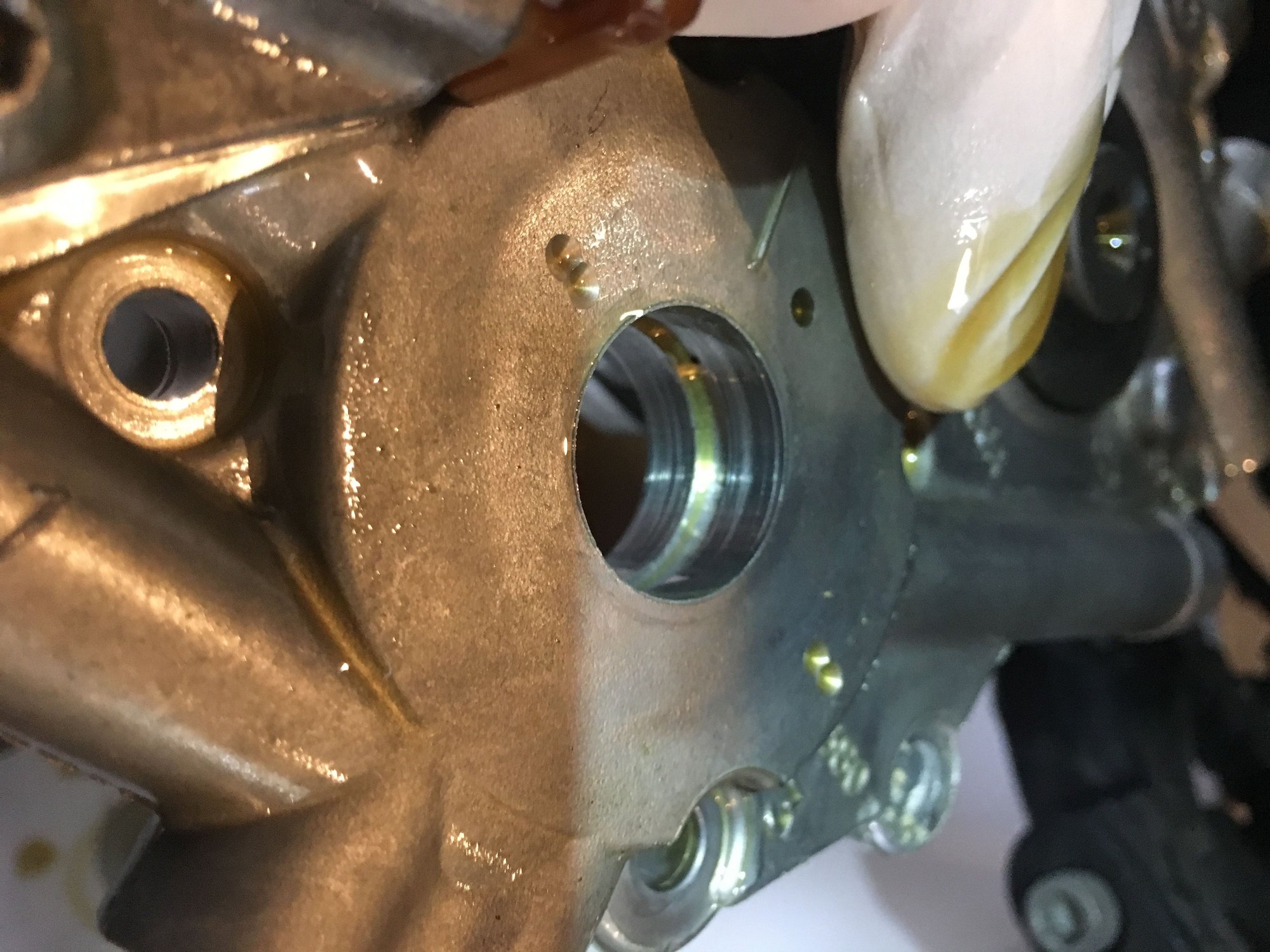

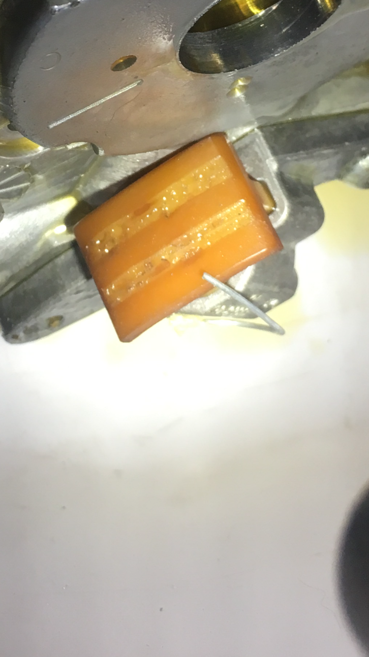

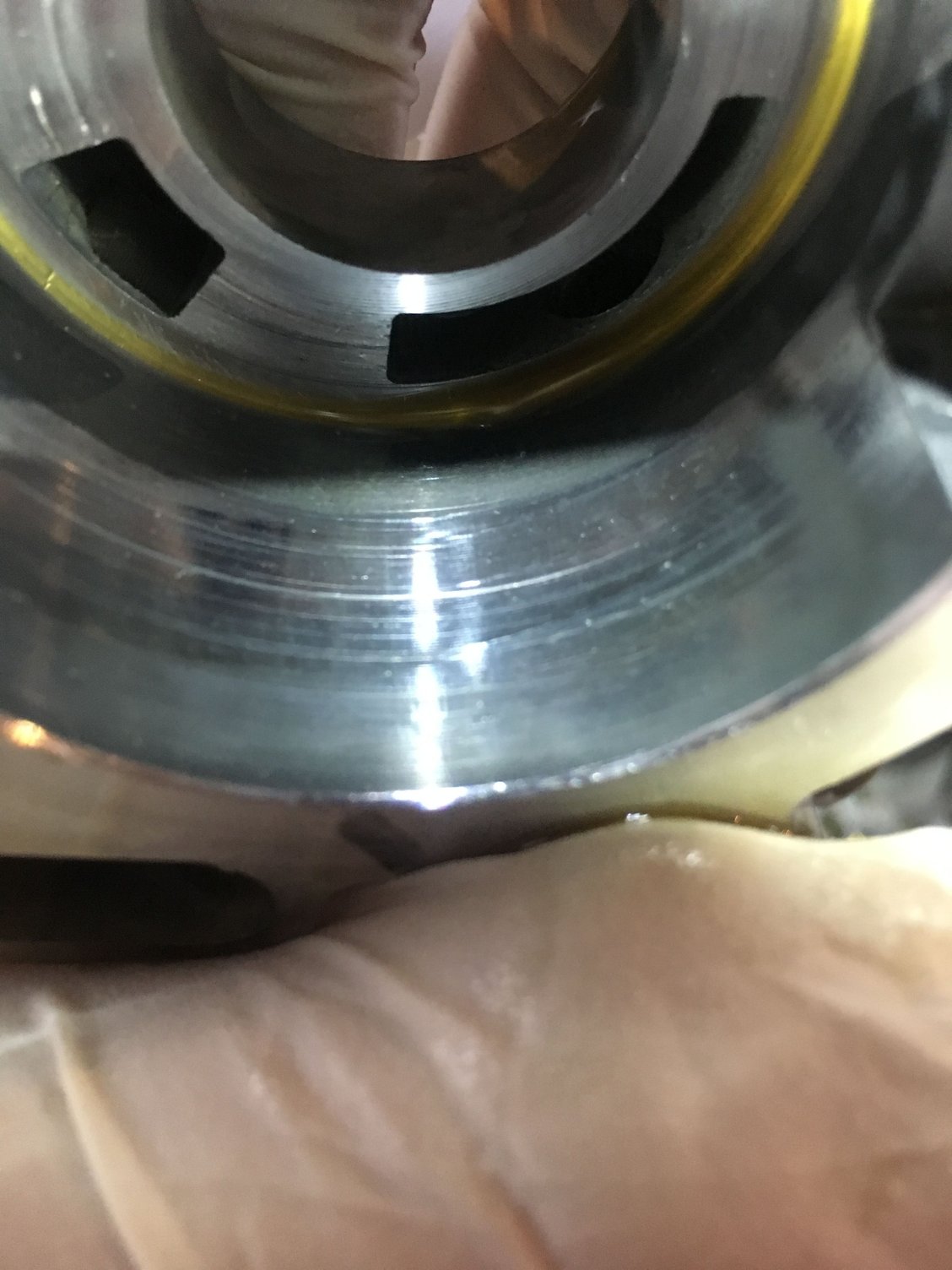

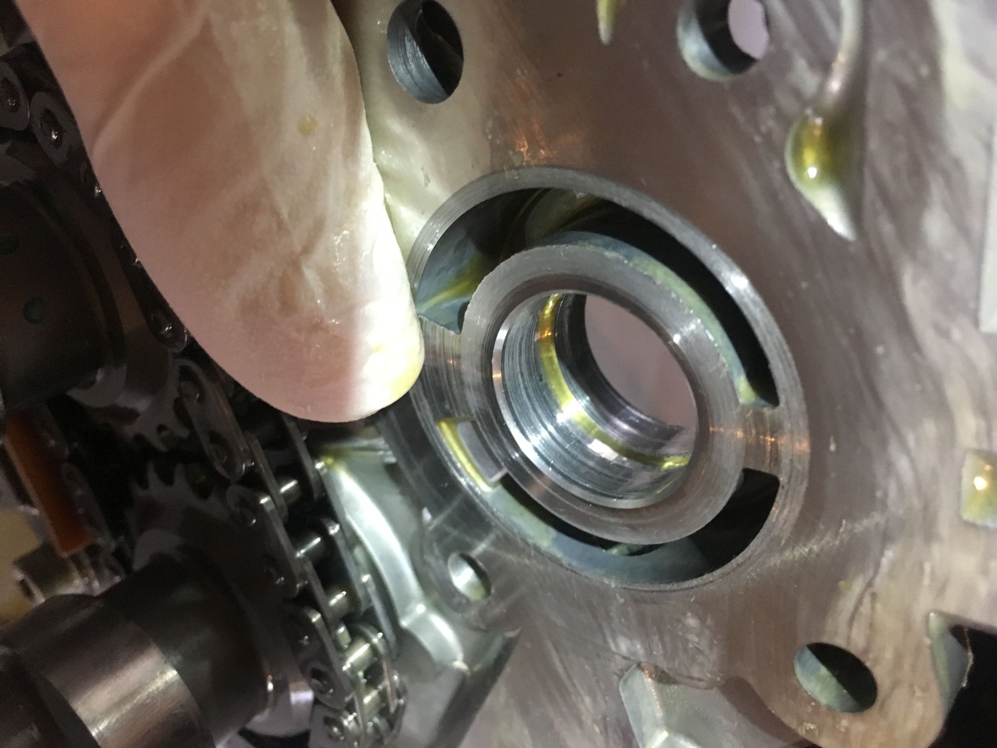

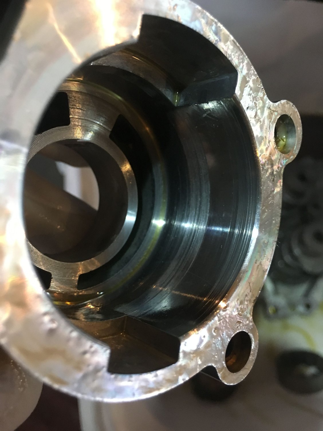

Anyone have to upgrade the cam plate and pump? If so what are the best options? Stared having noise sounded like a collapsed lifter or something and on teardown found scoring in the pump, cam plate, and the tensioners are worn out. Fortunately crank runout is within spec.
