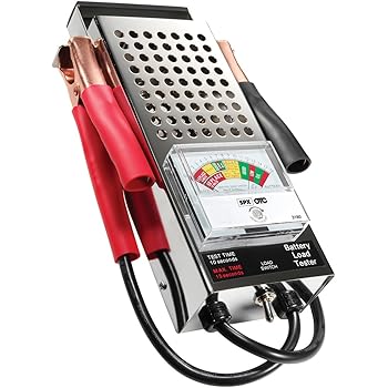

Old Jul 12, 2020 | 04:28 PM
Blue Bob's Avatar
Blue Bob
Joined: Jun 2017
Posts: 1,705
Likes: 1,017
From: Lawrenceville Ga.
