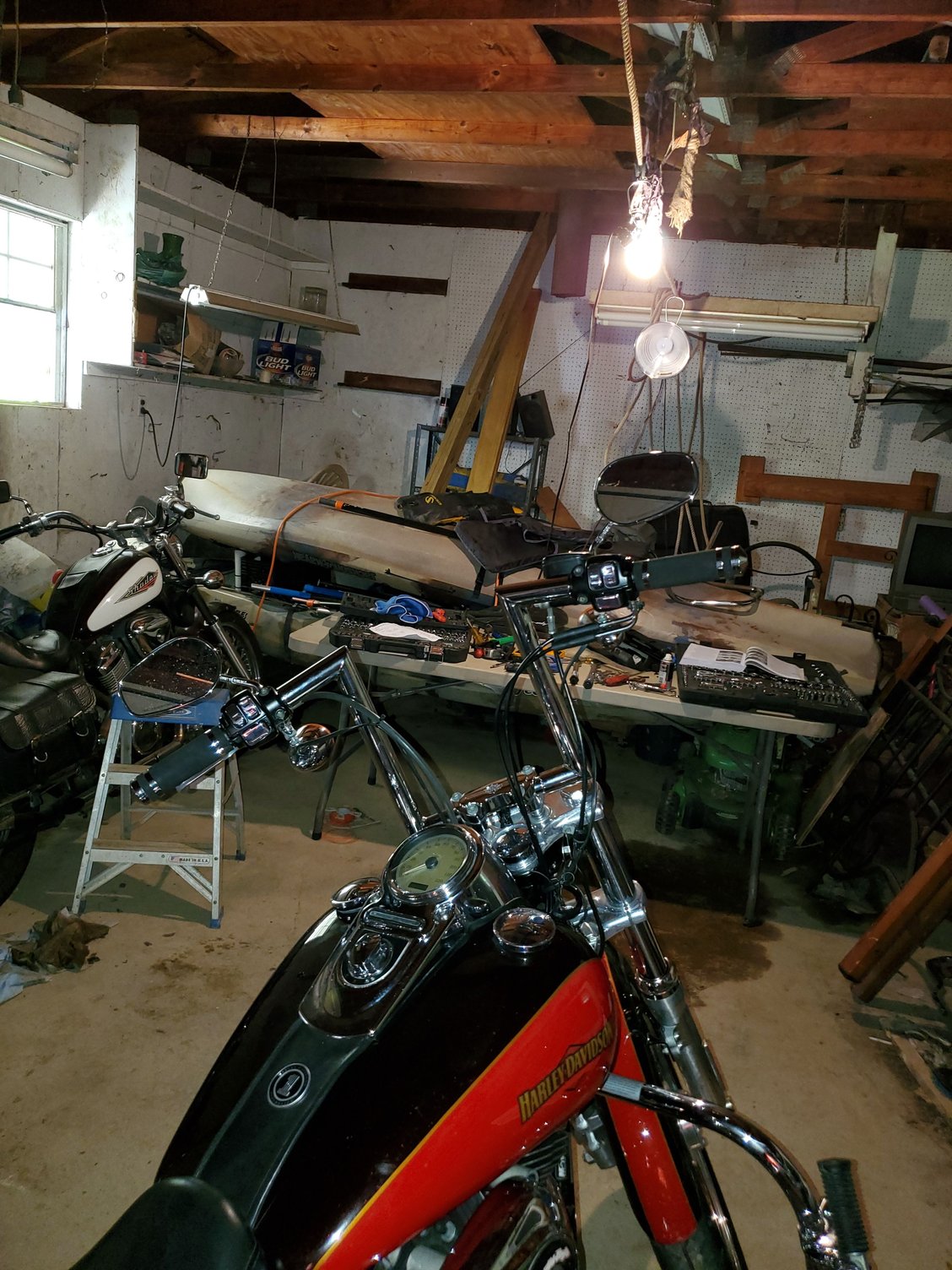

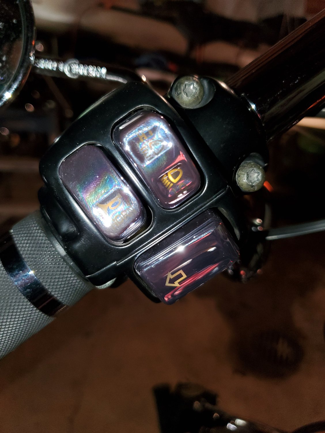

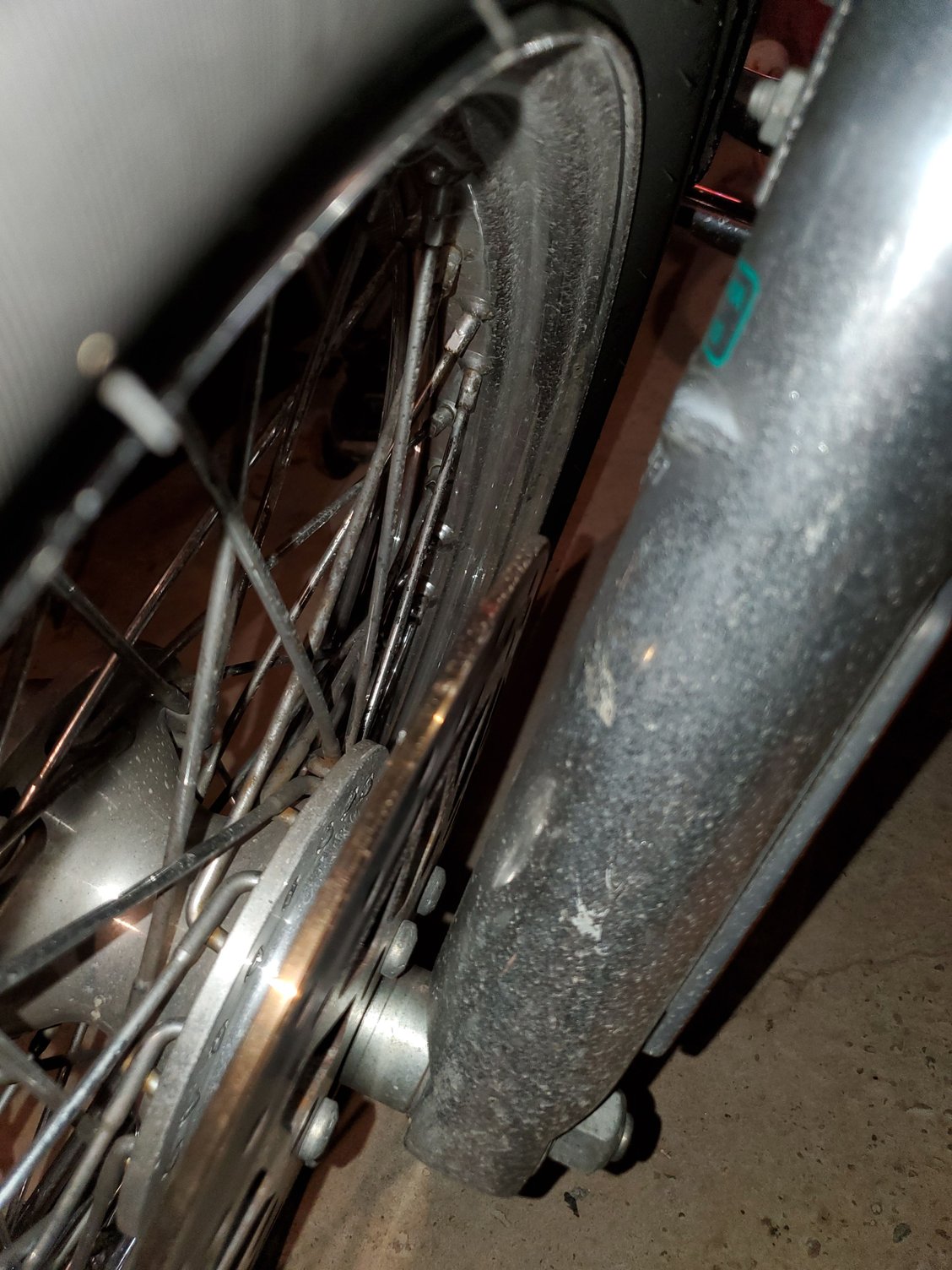

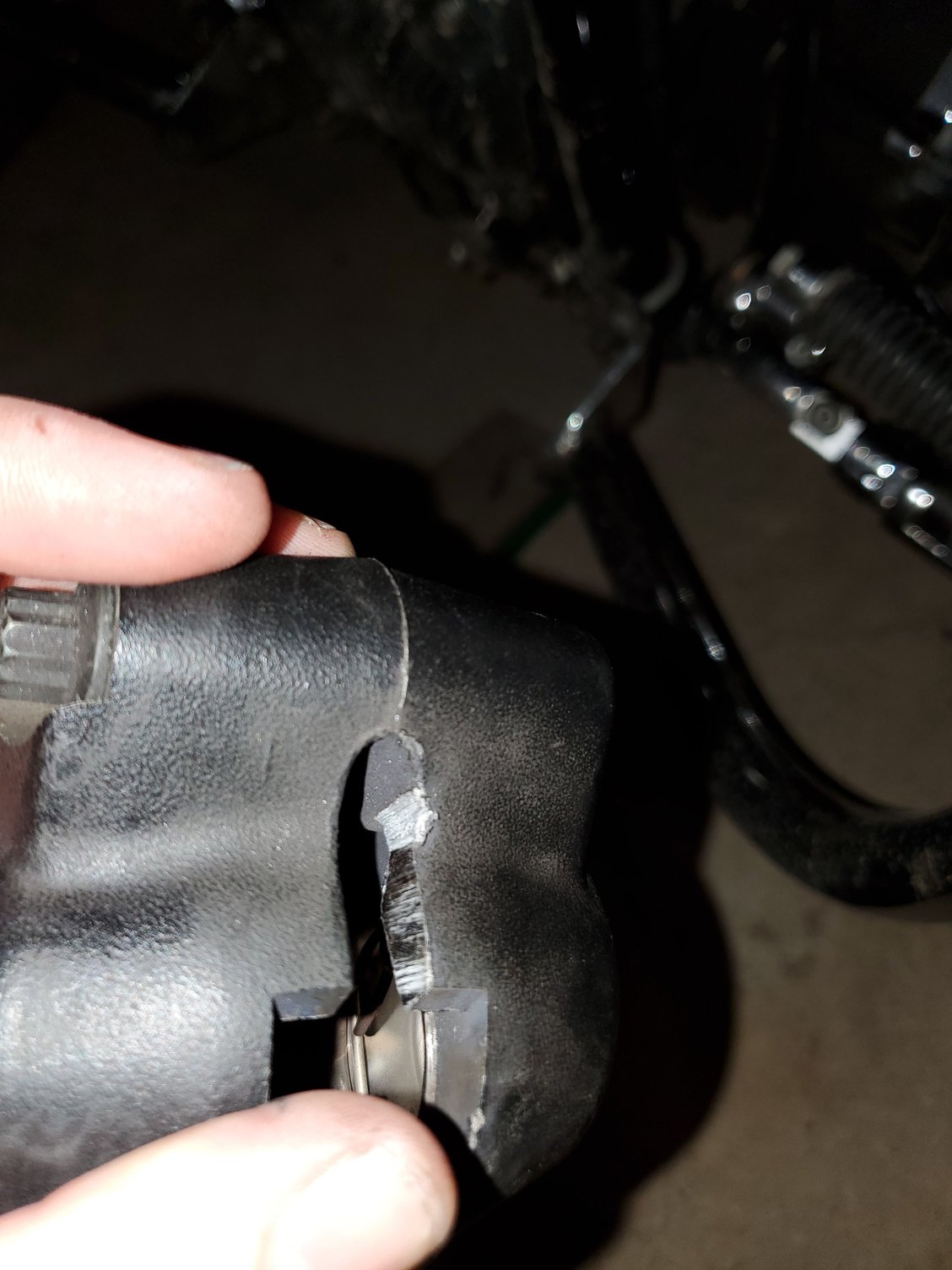

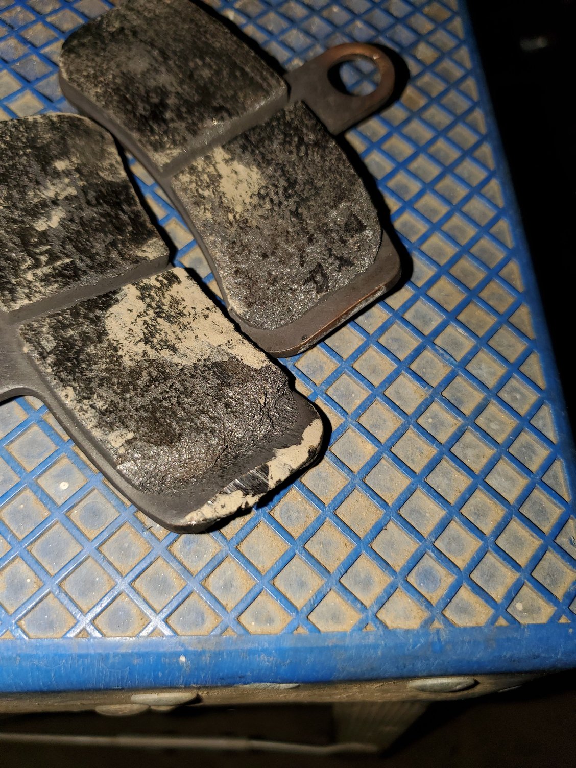

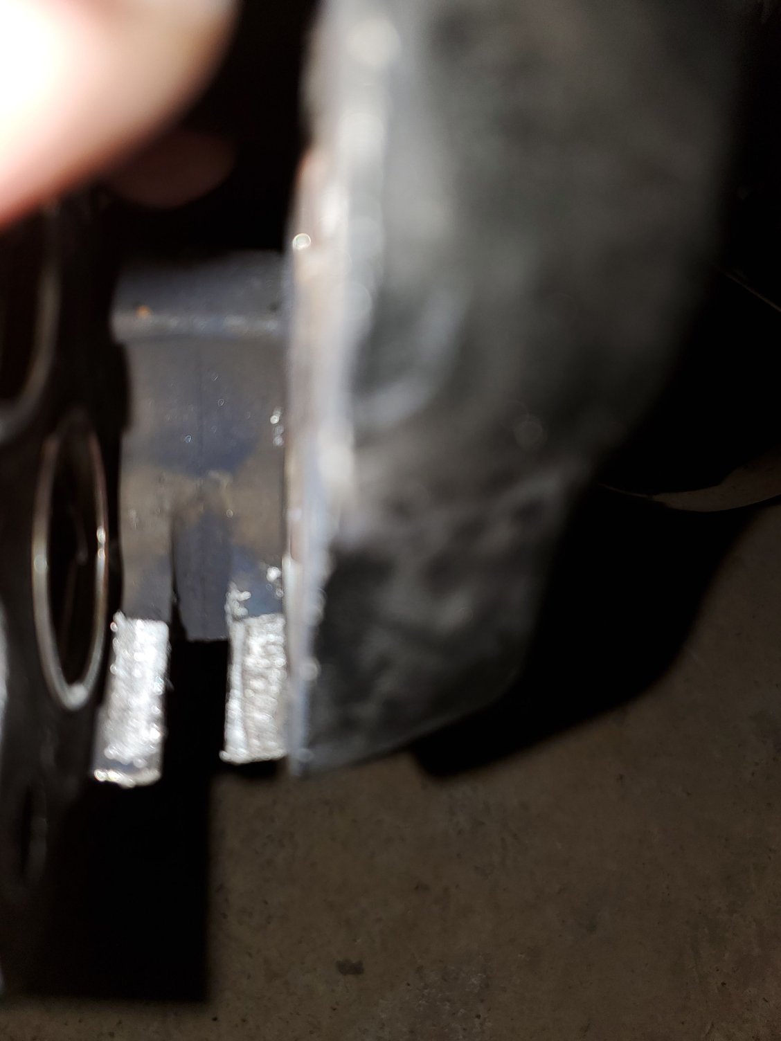

Well got my new bars installed they look great. But know I have bigger problems. I changed my switches for Chrome ones with back lights but forgot that my old ones the brake switch was broken and I had used jb weld to build up the brake hadle to hit what was left of the switch. So went for a test ride about 5 miles down the road i thought the bike was dying had no power ends up the front brakes were seizing up the built up brake handle was keeping the brakes engaged. I stopped took the handle off and broke off the jb weld but the damage is done the rotor is visibly warped that pads shifted in the calipers and damaged the housing. I think I can file down the rough spots on the calipers and be ok but pads and rotor are on order.
New fatty z bars
New switches
Warped rotor
Damaged caliper
Damaged pads

I don't get it. You do something dumb with JB Weld and it causes a problem. Hope you learned a valuable lesson. NO SHORT CUTS - DO IT RIGHT the 1st TIME. JB Weld is not a replacement for broken parts. Replace the parts and avoid another problem down the road.

Replace the rotors, replace the calipers and pads.
Stop taking shortcuts. Learn from this.

I knew when I did it it was a short term fix for the switch. I just wanted to show what happened and I won't be doing it agian. But if I ever mess up agian I definitely won't be putting it on here.
