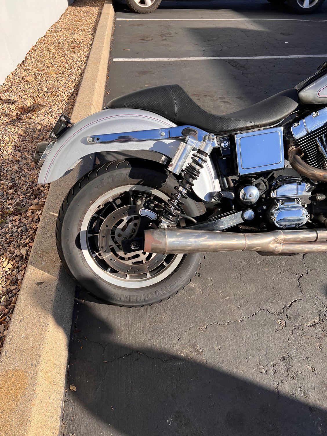

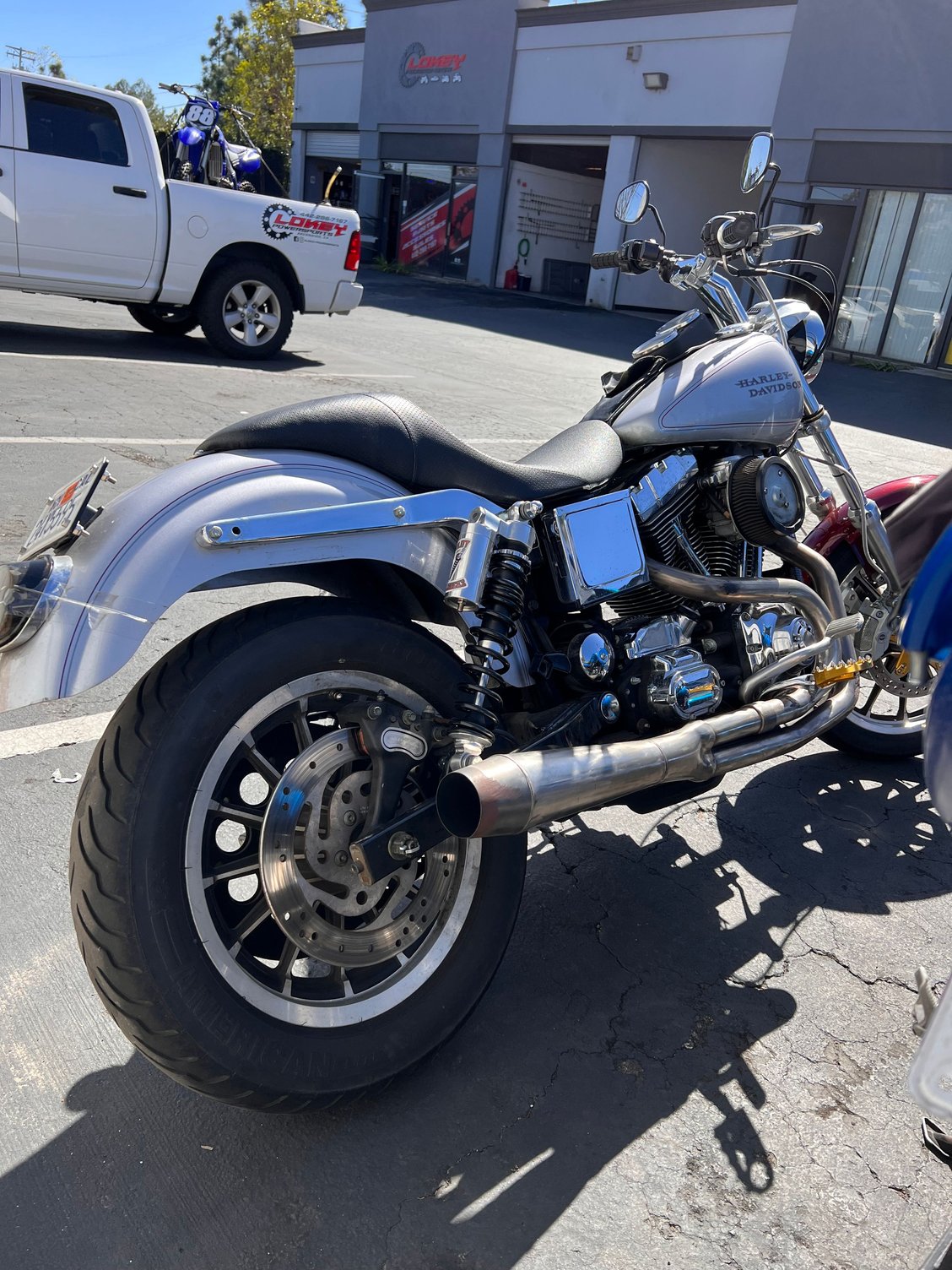

This may be a dead thread but this might help out. this is my 01 lowrider +2” racetech front end and 14.25” Works rears. Keep in mind this is an older dyna with a 16” rear wheel.

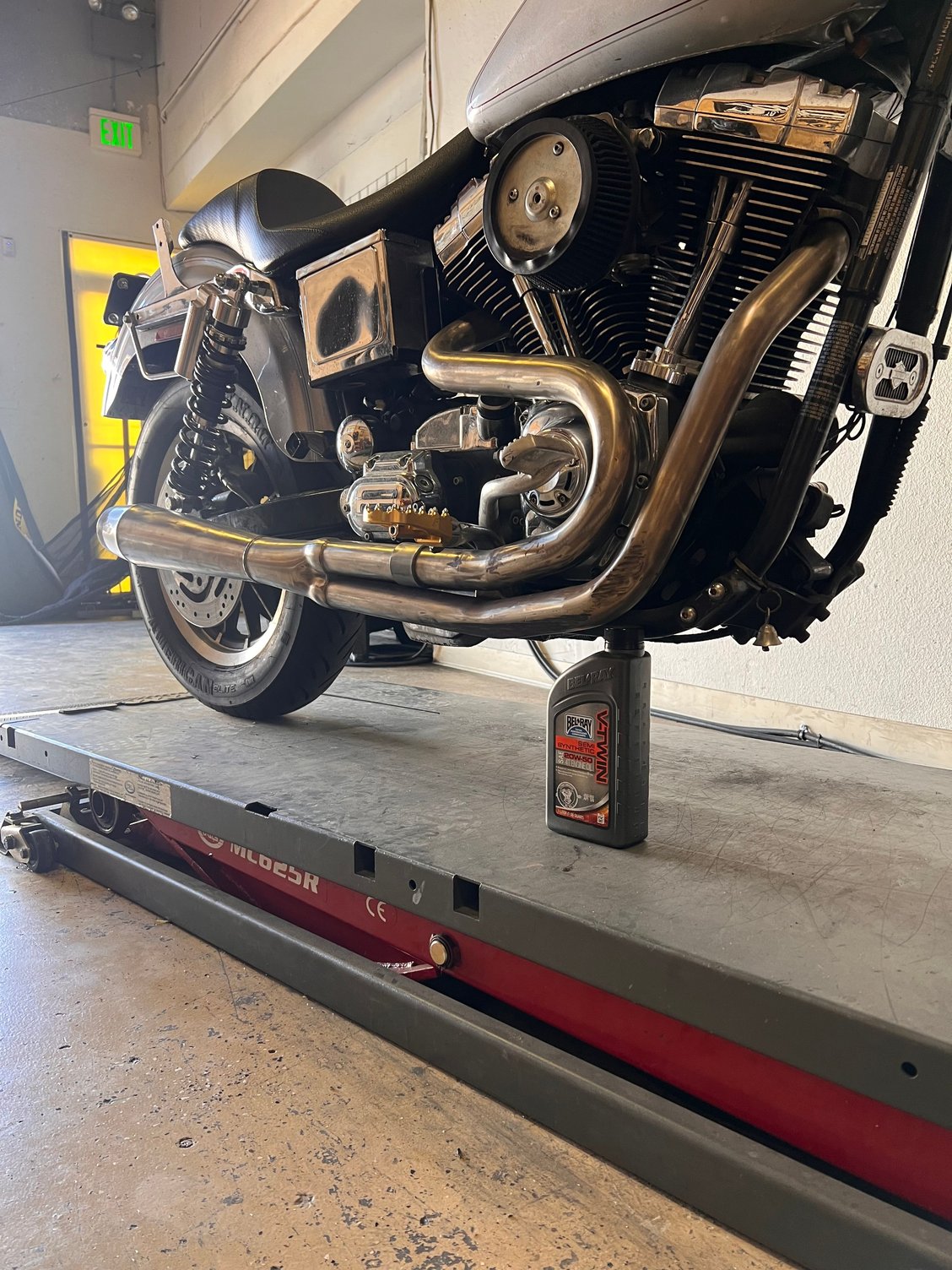

Never seen anyone use an oil bottle for a jack stand before!

might try to go even taller so I can fit a bottle of brake cleaner. At that point it would just be for show not performance.
