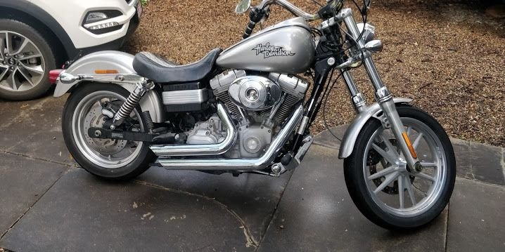

Background story: I've just completed a new build (pictures attached). Started out with a stock silver '08 FXD Superglide 96ci and ended up with a black 110ci. Photos below for those interested.

Photos of the build:
Before
After
