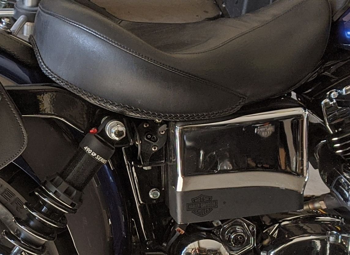

According to the 2003 FXDP parts manual there should be a bracket welded to the frame next to the battery cover. This bracket is also used to secure the battery tray.

That bracket also makes a great place for an SAE electrical connector
