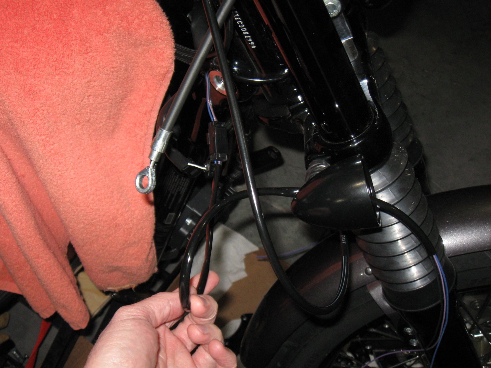

I got a 2014 street bob got the bike with no front turn signals and I want to put some on my forks. The problem is I can’t find the correct wires for them any help will be appreciated

Seeing how you're in Clarksville you're going to have to Monkey around with it; look at the two rubber plug stoppers in both sides of the neck where wires are coming out of, pull them out and on each side you'll find a plastic connector with wires, those connect to the T/s, all you need is some T/s with connectors and bam, you're in business!

This is the only connector I found that wasn’t plugged up would that be the one I use?

Must be it, should have another coming out the right side. Charcoal Pearl
Don't pull more wire out that you don't have to cause it all has to get stuffed back in there and it's a little pain, not much.

Okay I finally found it thank you
Color codes are:
pin #1 black for ground
pin #2 blue/orange for 12 v signal from BCM
pin #3 blue for running light power
See wiring info over here

I assume by I can't find any wires for them your referring that you don't know where to hook them up, right?? If thats the case then the main wiring connectors are located up under the steel frame backbone which is covered with a black plastic cover to hid all the wiring. Just pop it down & they should be clearly labeled RF & LF. I think they are black Deutsch 2 pin connectors.
