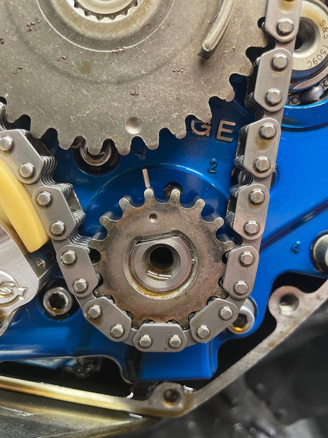

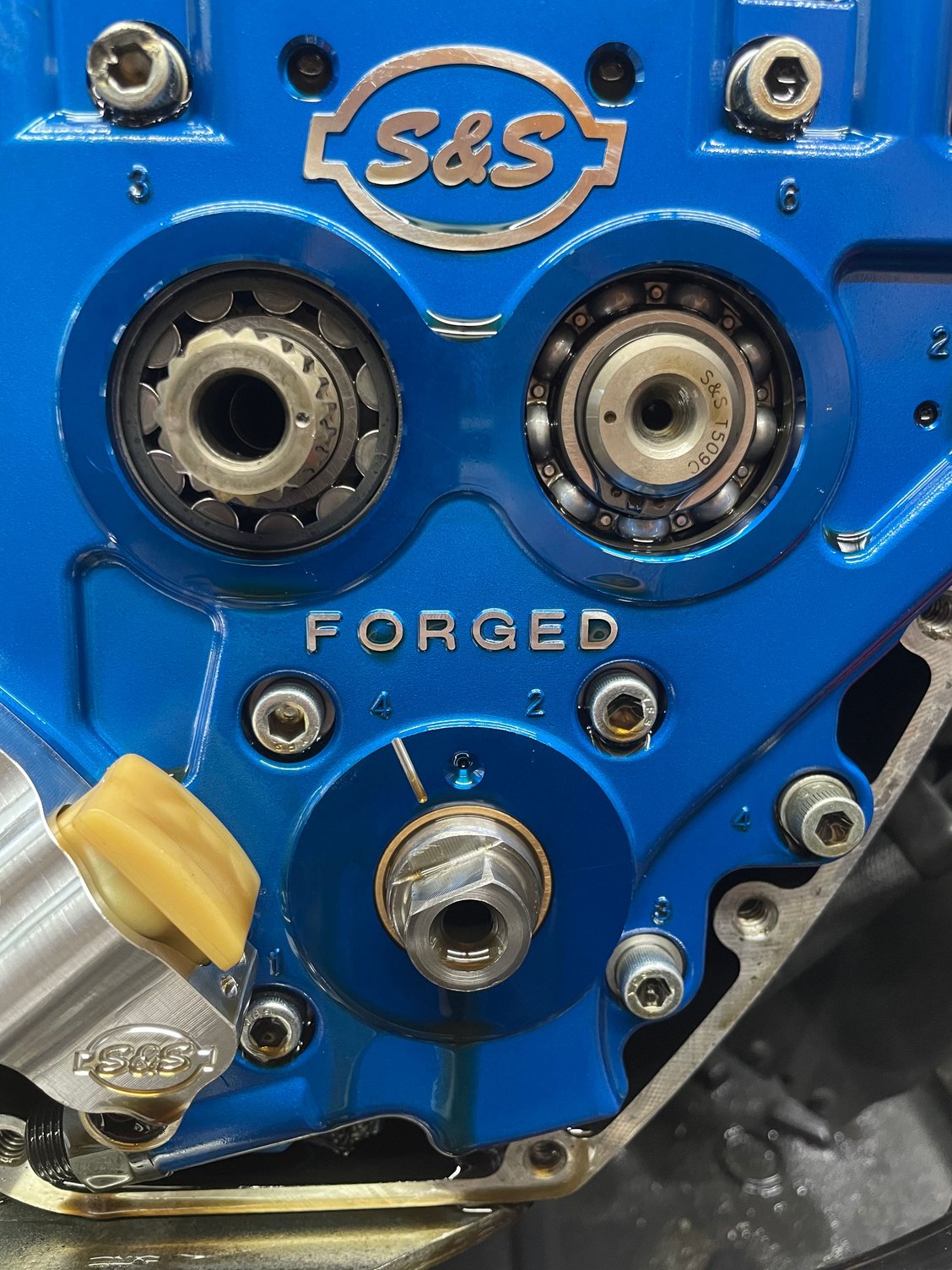

Ok! So I dug into the cam chest again and it looks like I have everything lined up correctly:
Maybe I should check the bearings while I’m in here?

You are right everything lines up.
Here is the thing. You are running SnS 509 cams. They have an early intake close and some overlap. You should not be running a stock ignition. I would suggest dumping the stock ignition and going to a DTT ignition. It won't have the same problem. In fact, you'll be able to remove the Cam sensor. It's a worth while change since you'll likely get some pinging with the stock ignition.
