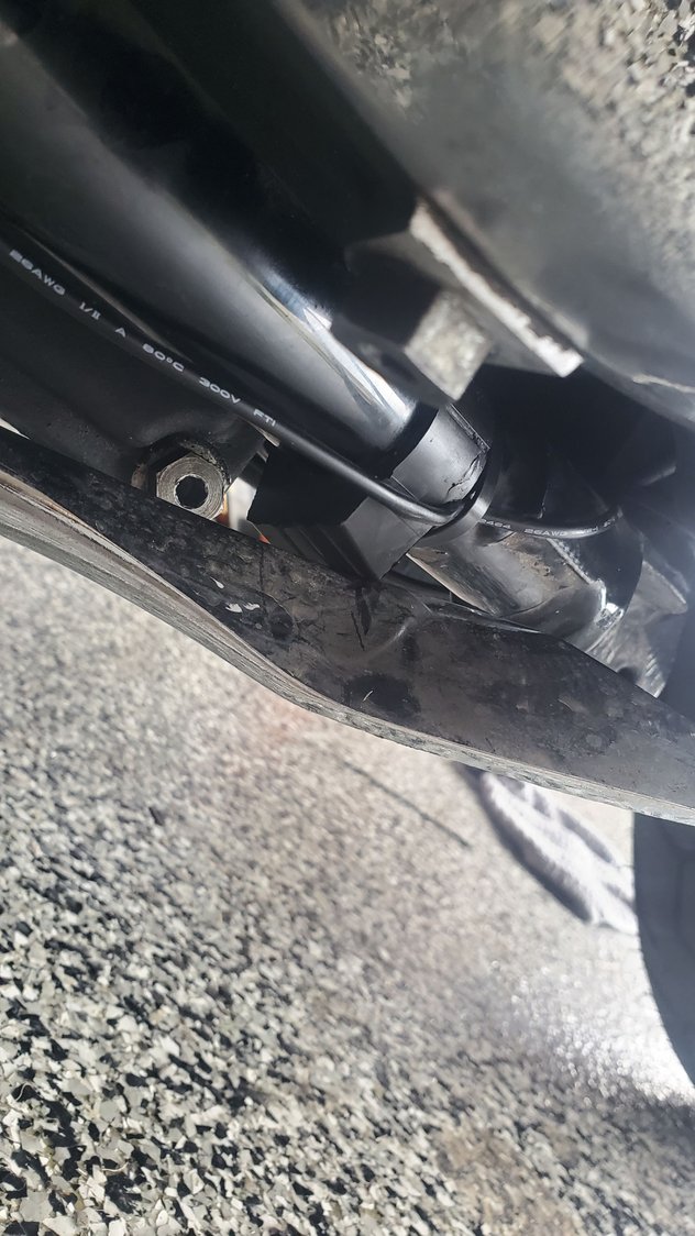

So the front tank bolts weren't crazy lose but it definitely took a few turns of the wrench to tighten them. But here is under the bike where the kickstand would hit. Is the pad missing or is it that blak strip by the zip tie?

The tank bolts can be 1/4 turn loose and it will still clank, so it's a good chance that was it.
Don't see a pic, but there shouldn't be any zip ties under the frame. There should be a black rubber bumper, though.

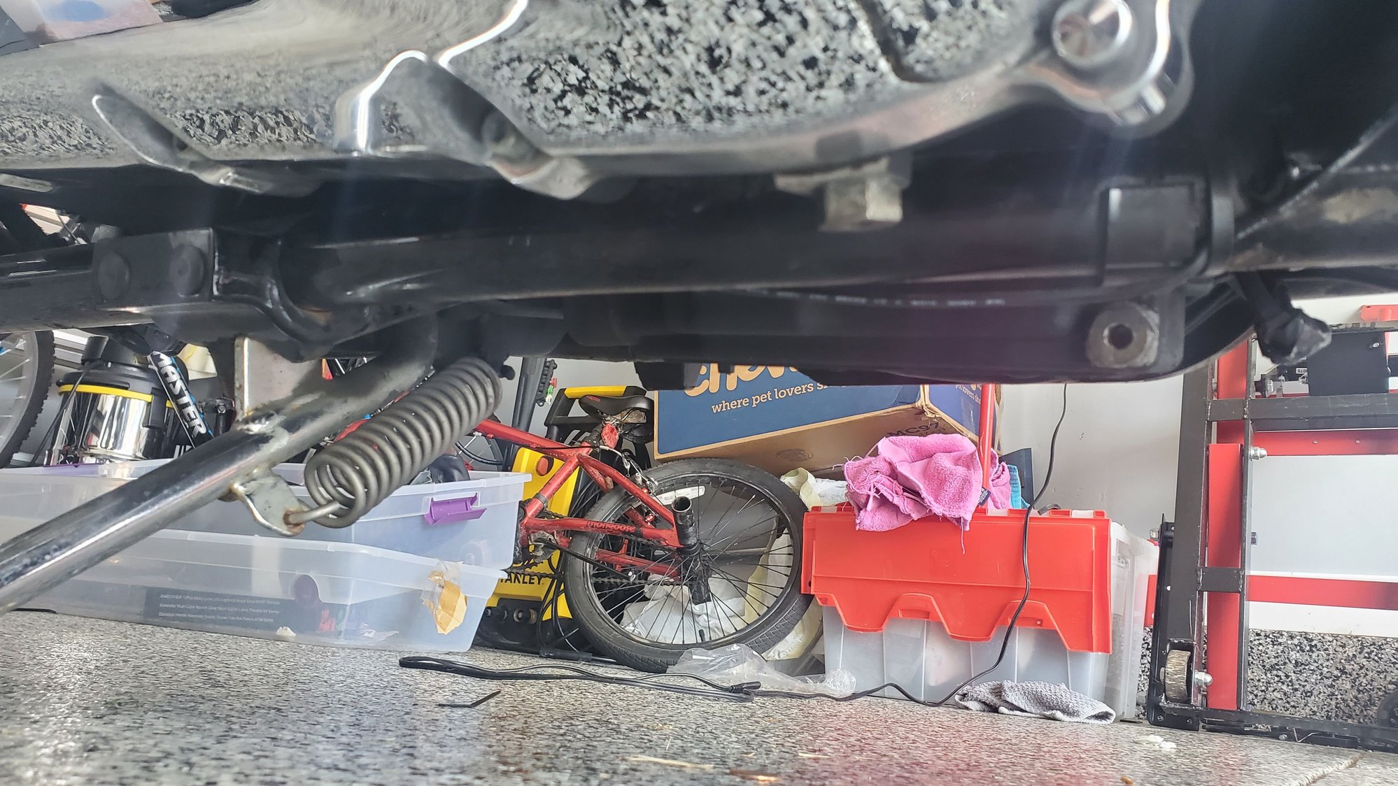

Looks like the bumper is worn flat on one side. Rotate it 180 degrees.

If the bumper for the jiffy stand has moved, likely from using a jack, it will contact the frame, sit on the bike and kick the stand up, if you hear it hit the frame.
Move the rubber bumper so the jiffy stand hits the bumper instead of the frame.
When you have the bumper in the right spot you won't be able to hear the stand come up.
it was turned to the back where you couldn't see it.

Always makes a clunk? I tightened both sets of tank bolts. Moved the kick stand bumper and put some sticky bumpers between the plastic under the rear fender cause that **** was rattling like no other.
