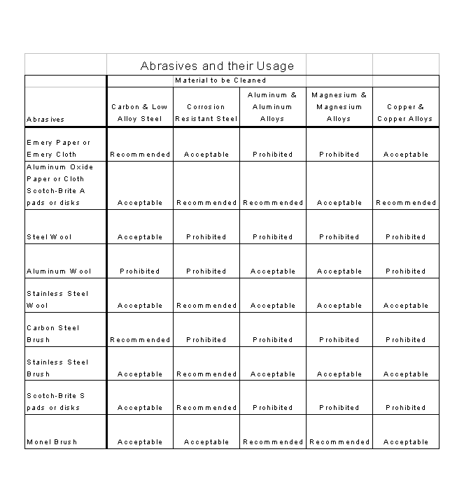

This is what we go by for aircraft. Note that there are two different types of Scotch-Brite.

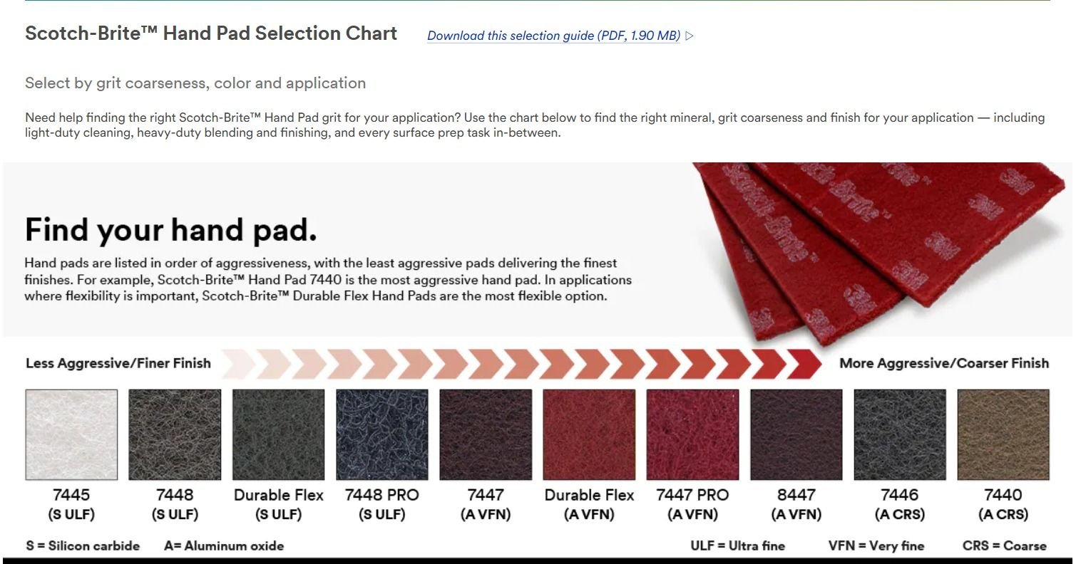

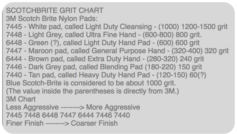

Thanks John, that chart is worth saving. This thread led me down the rabbit hole to this...
Great chart!! I have white / light grey / green / and maroon and use boxes of it.
I also use mounted scotch brite wheels and a 6" wide belt.
I couldn't work without them.
