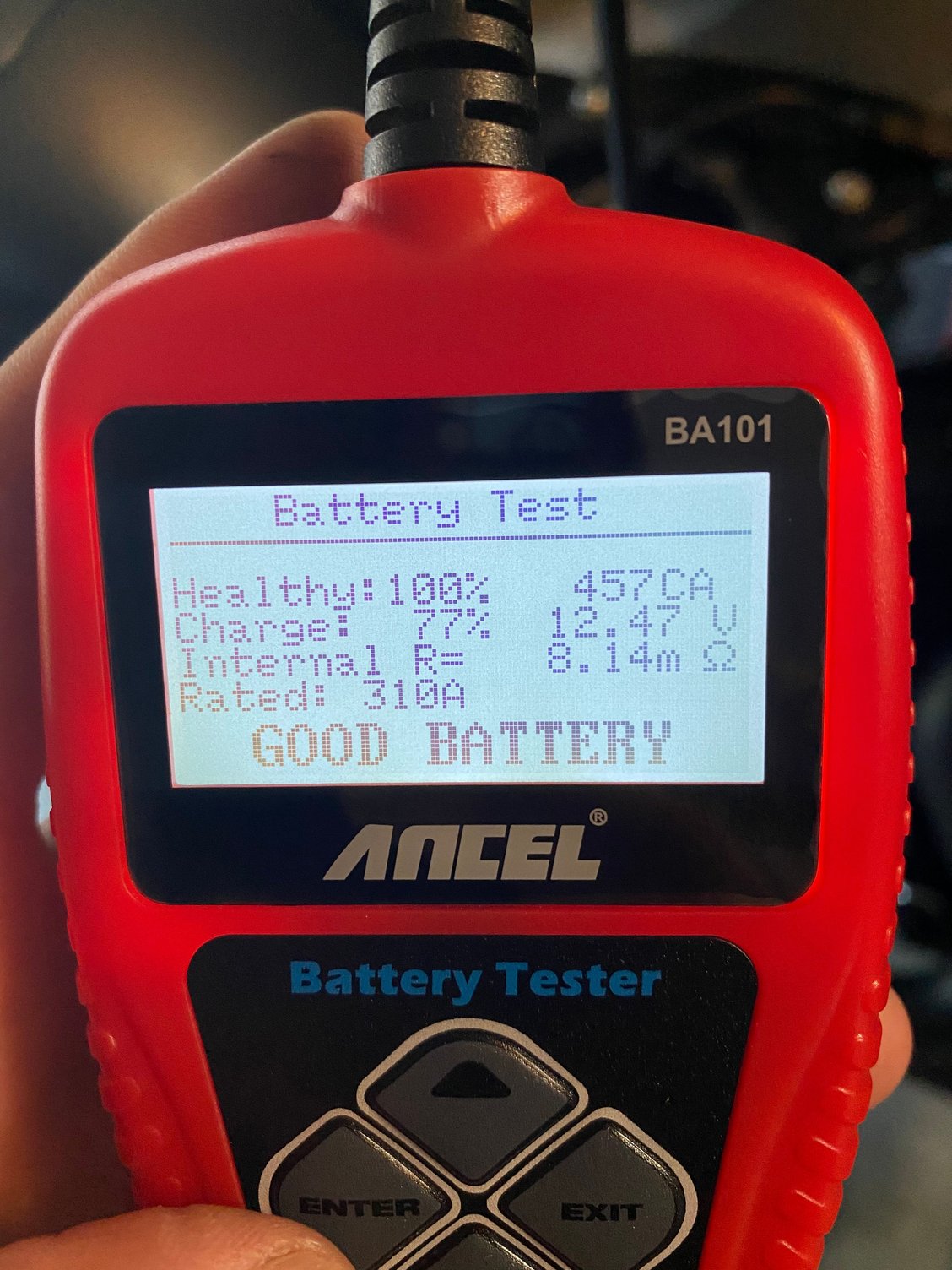

Here’s what home tester gave me.
Tender on the way, and the ground screw was not as snug as it it should be. Wonder if I should put a little blue lock-tite on the battery post screws.
Thanks for the replies so far!

I suspect that you may have solved the problem with a loose ground screw. Good Luck!
