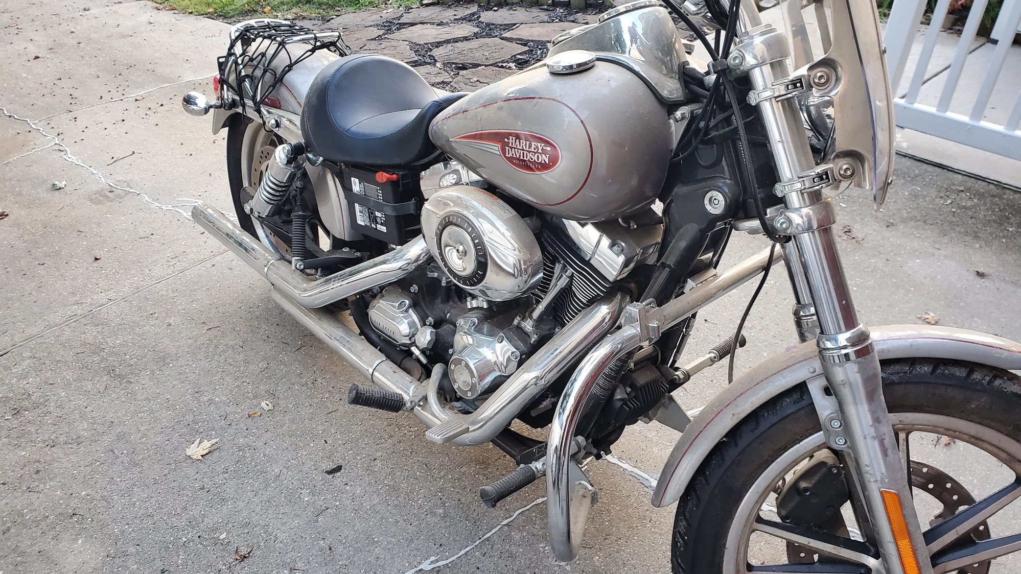

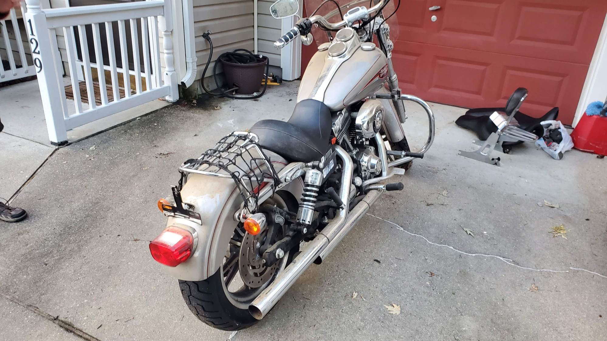

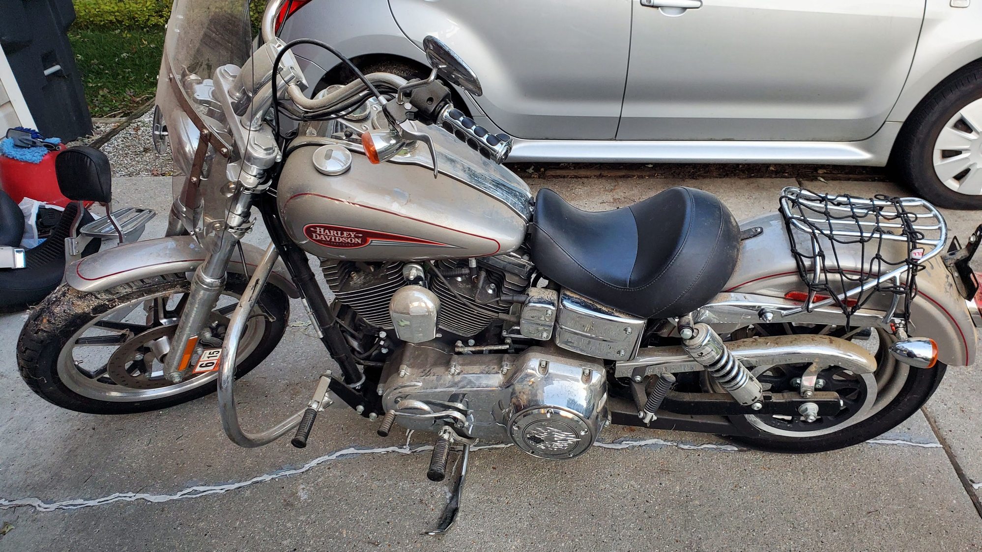

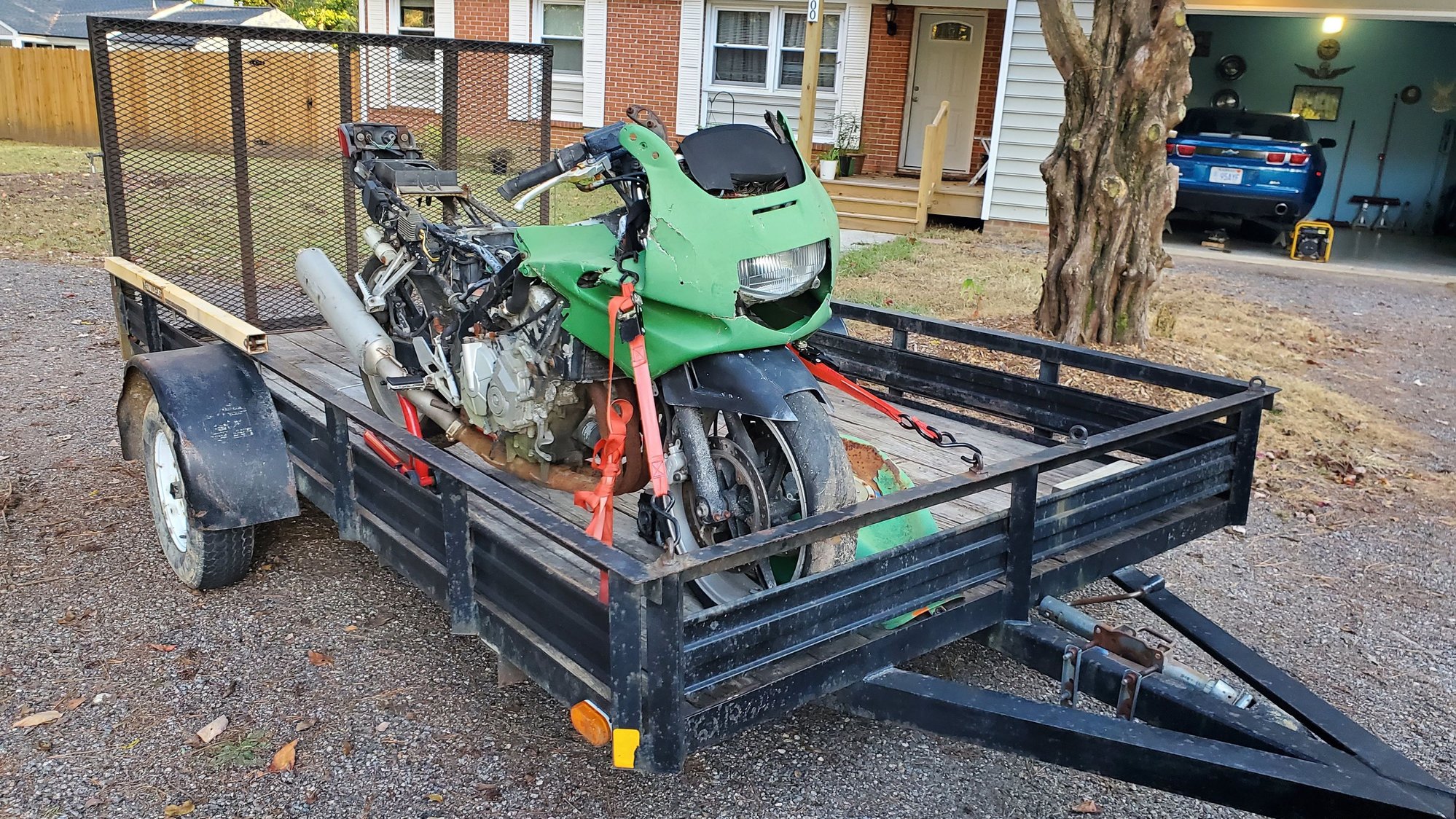

A few more pics after we got the Dyna out of her garage and when we got it home. As a bonus, another friend gifted her sons 94 CBR600F2 to me. It's a basket case, but I get to restore it into one of my dream bikes, a Camel Racing Smokin' Joe CBR while teaching my son and daughter to work on bikes.
2007 Dyna Low Rider - My wife's new to her bike.
1994 Honda CBR 600 F2. Going to be restored as a Smokin' Joe replica.

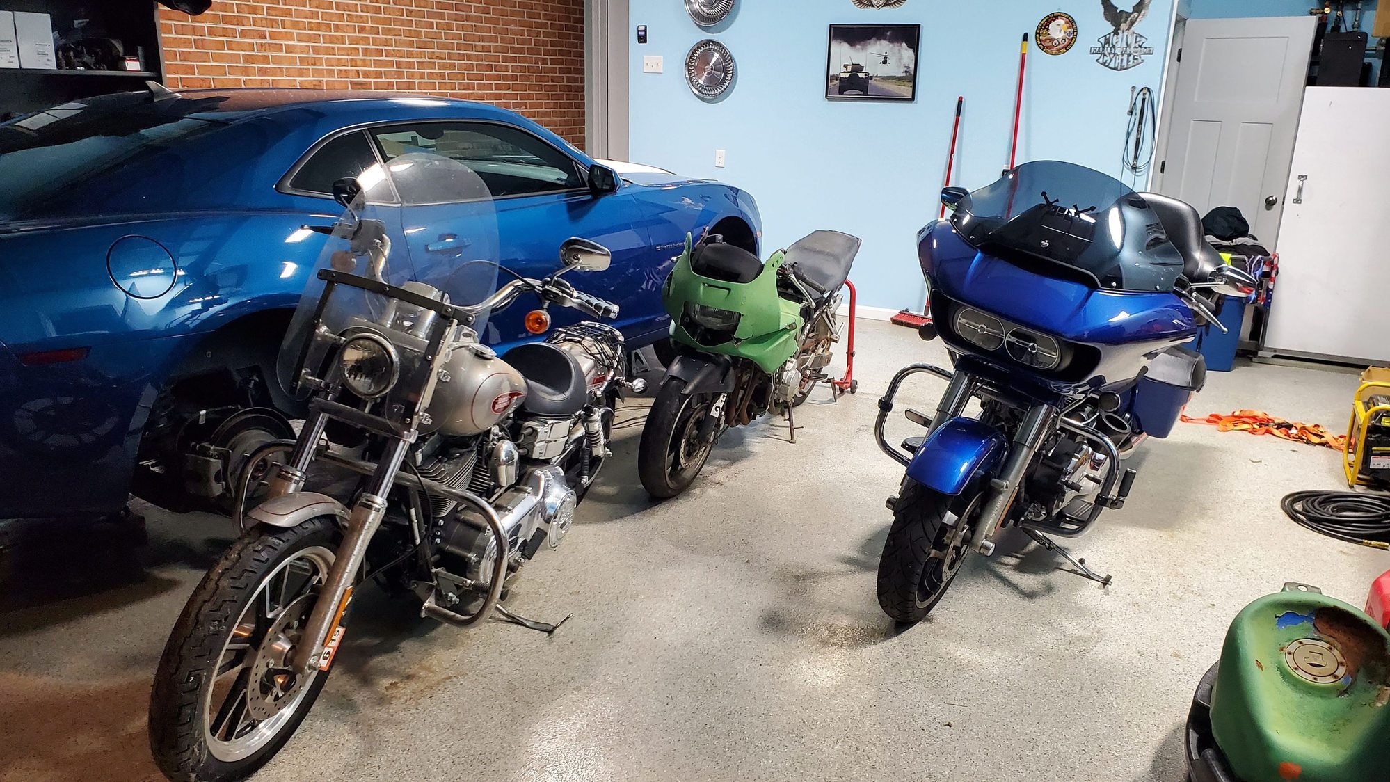

The new bikes keeping company with my 2015 Road Glide Special.

EDIT~ As far as things to inspect, how do the fork tubes look? (In the pics, they show either bad corrosion or lots of dust. Either way, you might look at fork seals. (The 49mm fork has been known to eat fork seals quickly.)
Another thing to look at...
Brake pads. Not just the remaining material, but the "crystallization" of those old pads. Check the caliper pistons for corrosion too.
Pull the seat to inspect the wiring. Rodents have been known....
Pull the air cleaner, rodents have been known here too.
Check the drive belt for cracks.
Check all the nuts/bolts/fasteners to the correct torque values.
Throttle operation...smooth with a quick return to idle?
Basically, an "enhanced" T-CLOCS would be a good start.
