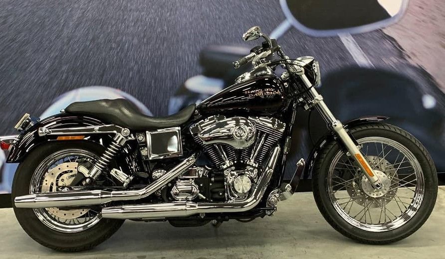

Here is what she looks like......

Look at the cam chest cover and see of it has a CPS, it routes in from the outside. My guess is that it does not have one.
