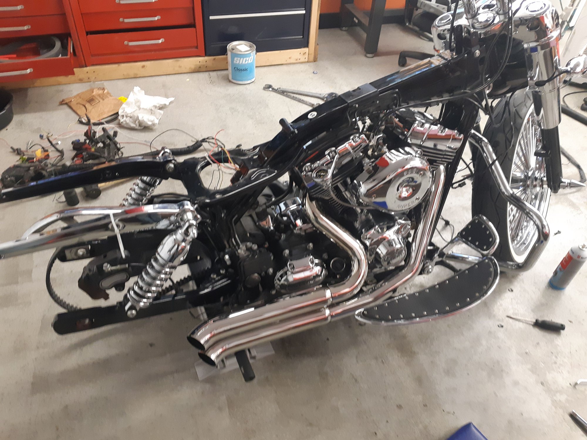

-Removing all factory harness, ECU, BCM, fuel pump, speedometer, control switches, ABS Module, ABS Sensors, Injector, Throttlebody, etc etc etc....
-Replaced by a BRAND NEW S&S Super E Carburetor
-Replace the stock speedometer for an Dakota Digital (Needed for the Carb conversion)
-Replacing the factory harness for a custom ThunderHeart Standalone Module
-Replaing my Vance & Hines exhaust for a new Bassani FireSweep 2-1
-Replacing the saddlemen seat for a LePera Barebones
-Got a brand new Softail Heritage front fender (now at the paintshop with the rear fender)
-The factory Automatic Compression Release has been removed and the heads ares been ported and drilled for manual decompressors
-Cams ares been replaced by S&S 583
-Pushrods has been replaced with S&S Quickee and the lifters for news CompCams
Now the bike run on a standalone module made by ThunderHeart. The bike is no more fuel injected, it's now back to old school carburetor with the great trusty S&S Super E.
The bike run now with no ABS, everything has been removed.

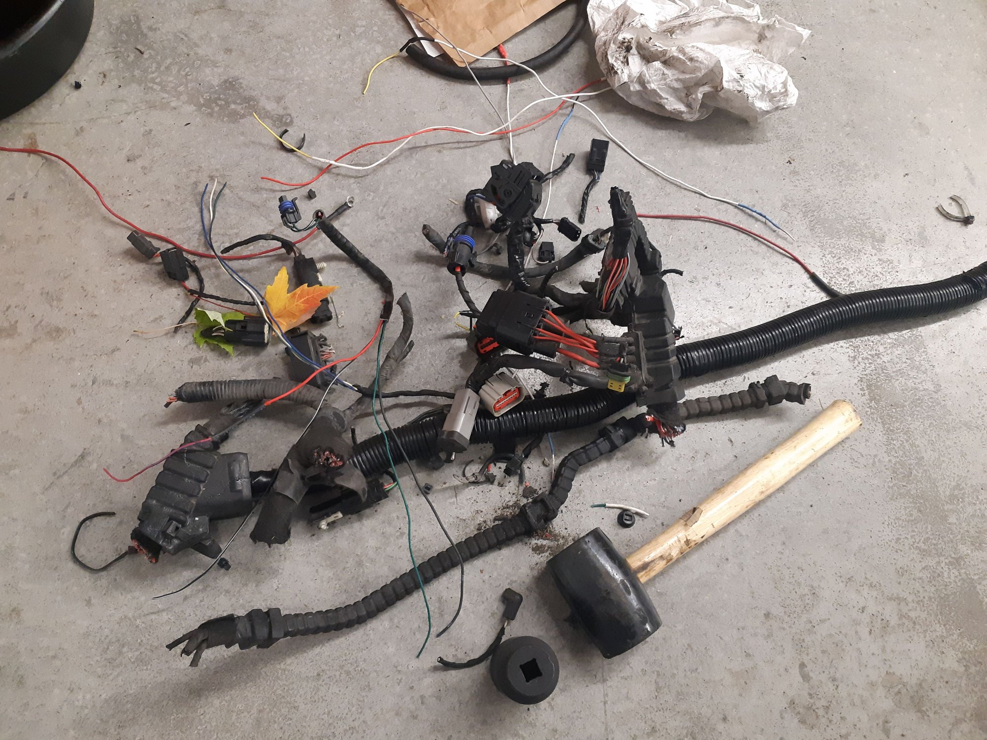

I took this picture at the beginning of the installation of the custom harness.
Factory Harness has been removed!! Yes I use my cutter to cut trough the wires... I don't care, I trash the harness once it been removed

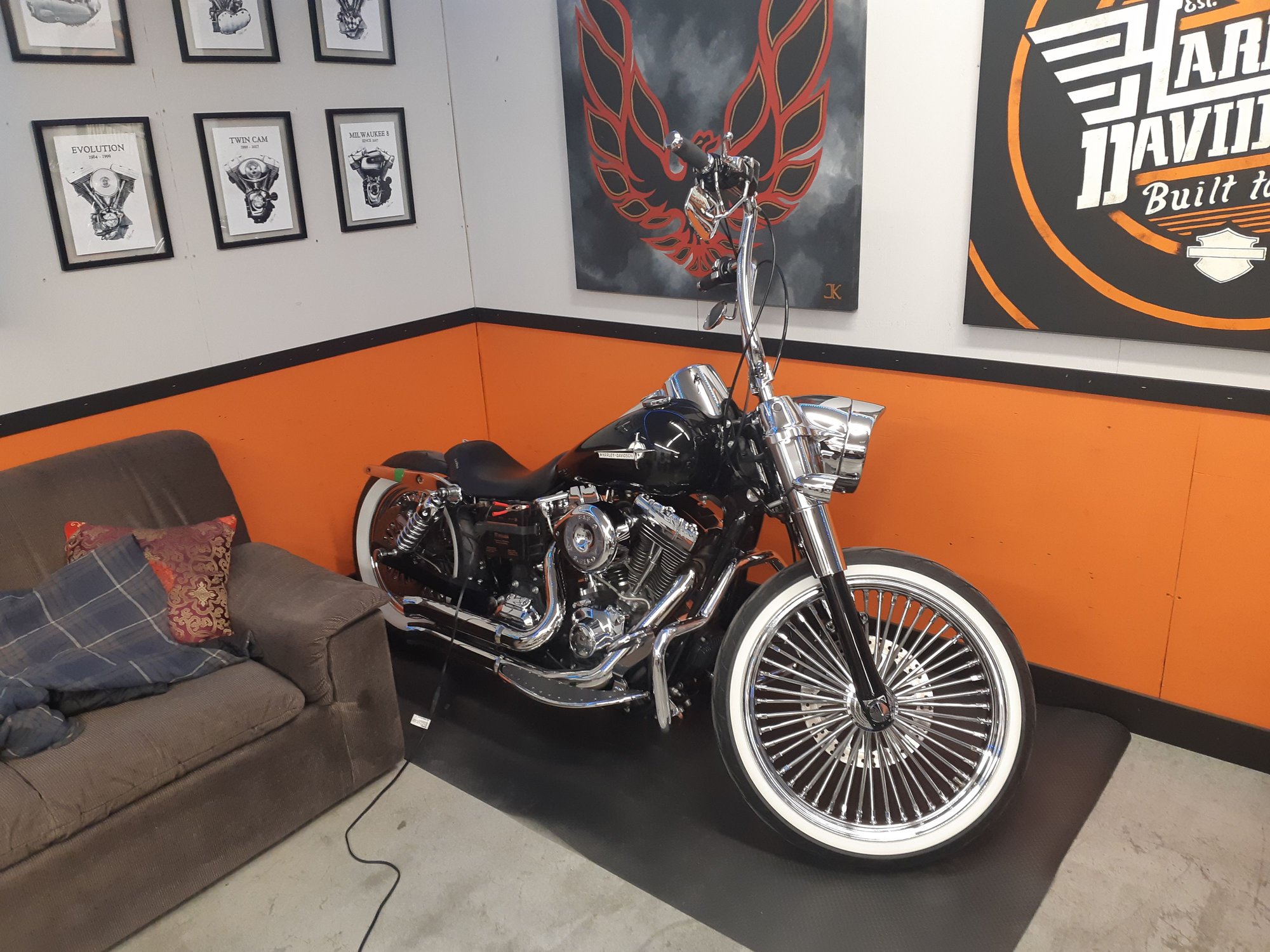

This is how the bike sit has today... The front and rear fender ares both at the paintshop to be painted!
