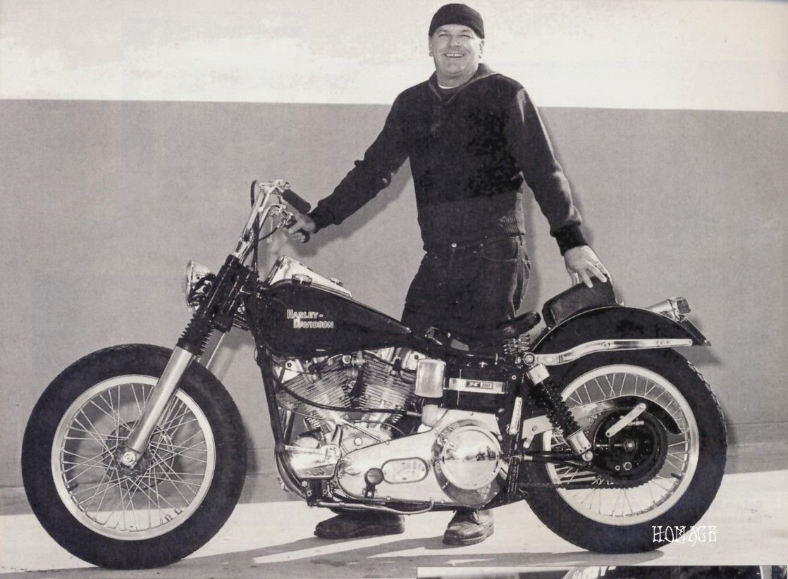

This was the motorcycle that sent me down the Harley-Davidson rabbit hole. I first saw this photo in Hot Rod magazine in Bob Green's column "Up On Two Wheels". I found it in my grade school library. I was 12 years old and never forgot it.
: Mike
