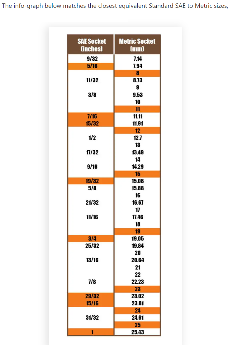

Info added to the ***dyna models metric sizes database***
In general check out the images below to determine socket sizes...(info copied from rustyautos.com)
Huh, 55 years old, been wrenching since I was in diapers and I never knew about that fastener/socket size correlation. Thanks for posting that!
There's one for socket head cap screws to....
