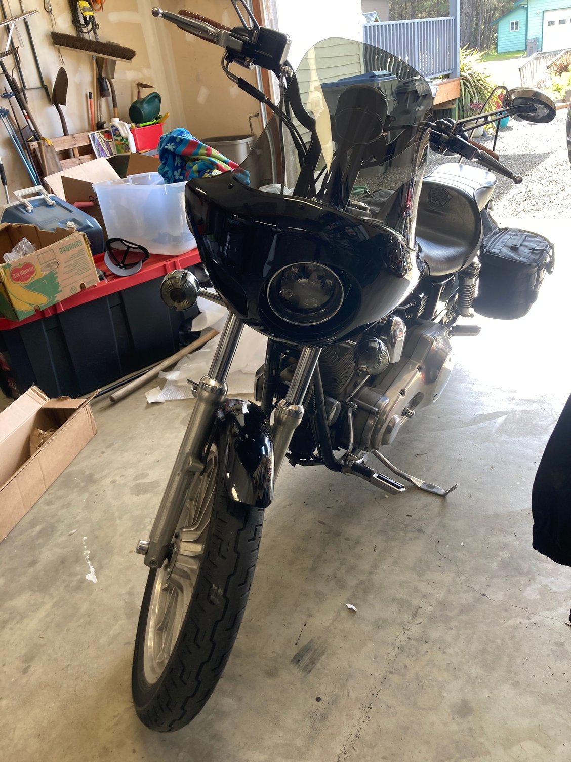

So I ended up going with this one - a cheapie from Amazon due to needing it quickly. I actually was going to get the Burley version (looks identical) but it only comes in opaque black windscreen and I wanted smoked even though the view is a bit distorted.
It went on easy enough with a little trial and error. Still a few things I could clean up, but overall I’m pleased. Definitely not the wind protection of the batwing, but good enough and my head is in cleaner air with this one. At 6’1 I’m looking well over the top.
