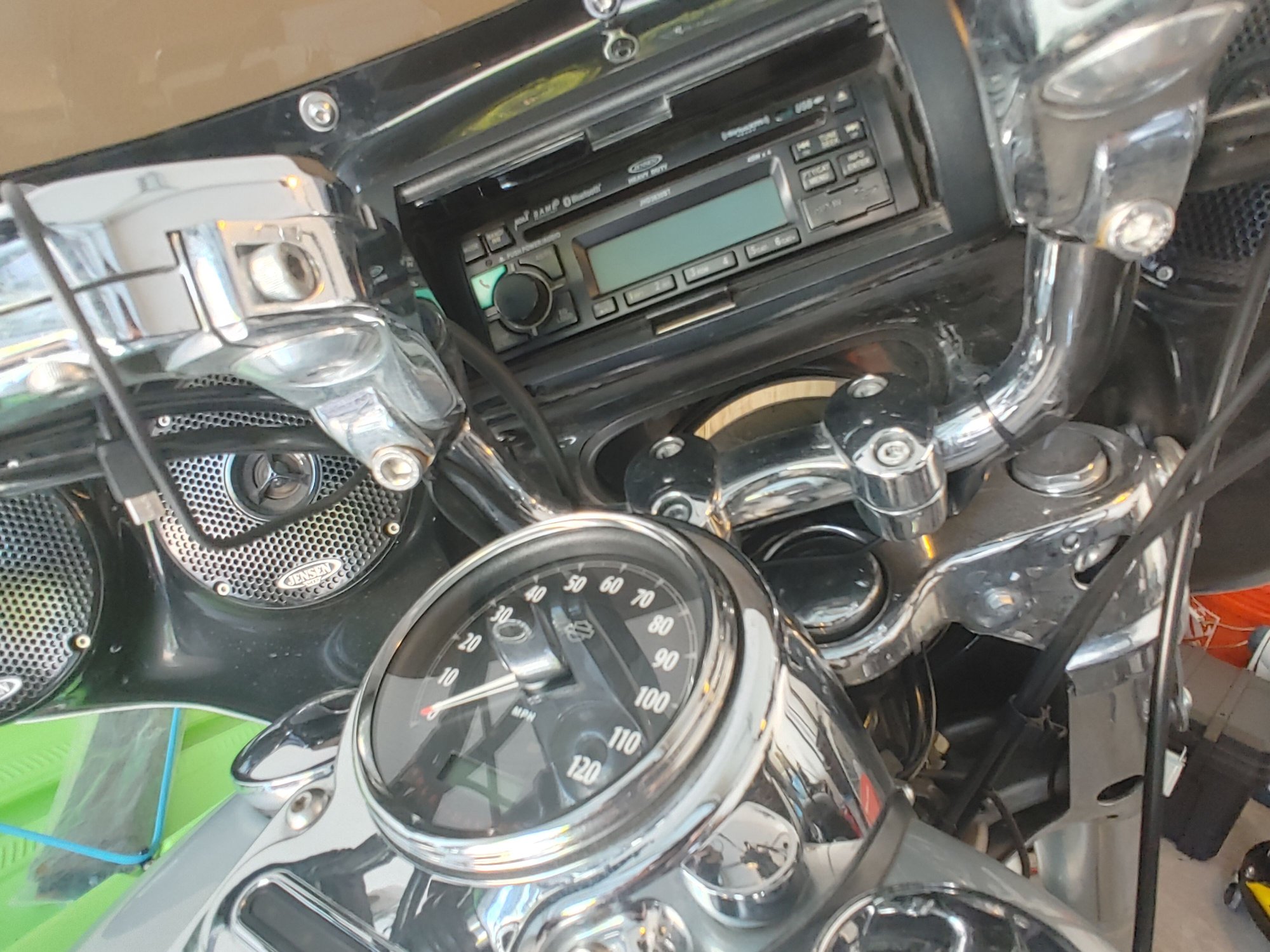

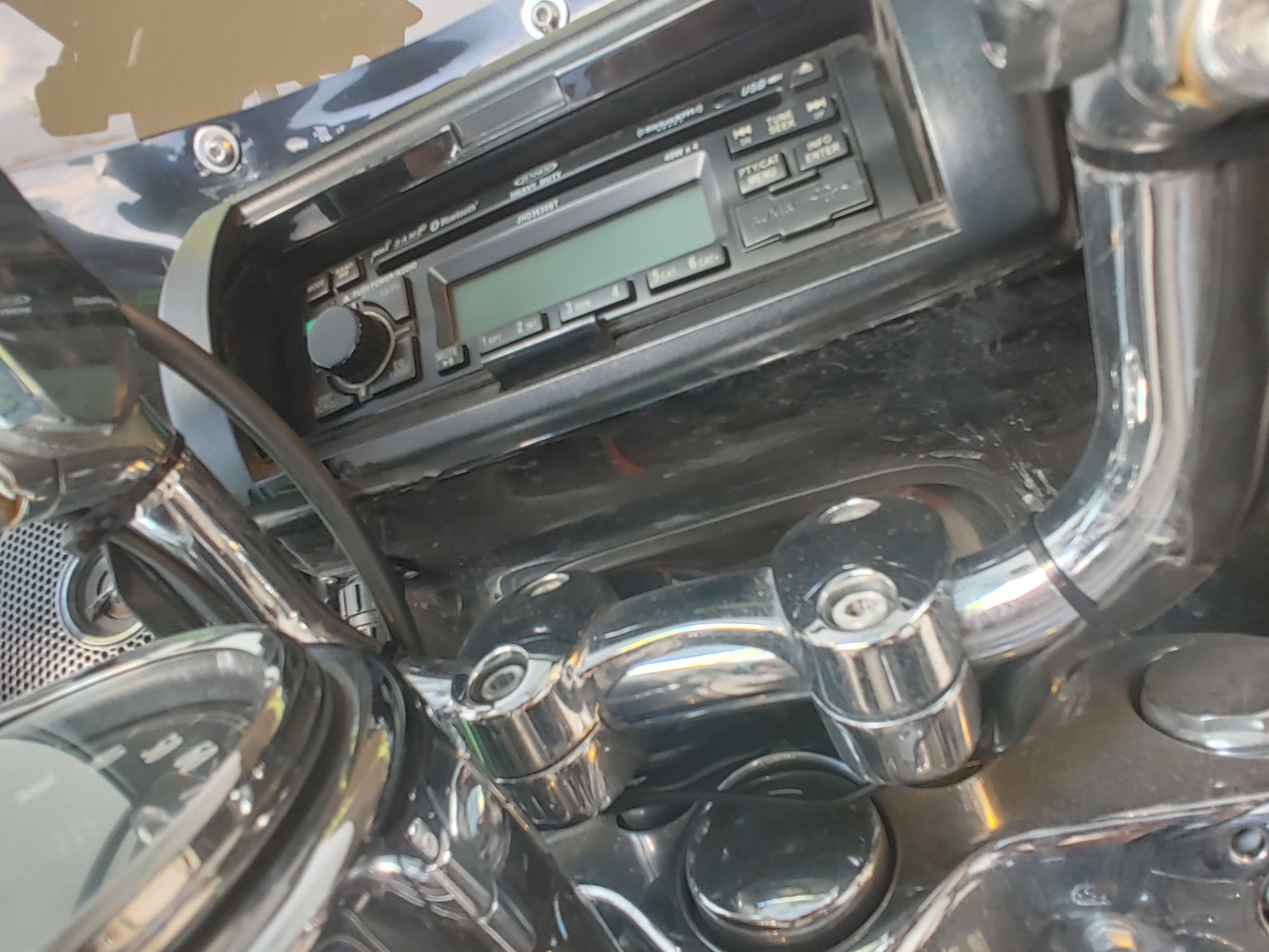

I have a 2012 Switchback with an aftermarket batwing fairing:
https://hoppeindustries.com/products/quadzilla-for-switchback
The bike has these short pullback bars on it and I want to get some Wild 1 14 in bars put on. I'm not sure if I should be getting the Classic 14 in apes or the 14 in Bagger bars. The Bagger bars seem to be the better option being that they are curved on the bottom to clear a fairing. Would I be safe getting either of these bars?

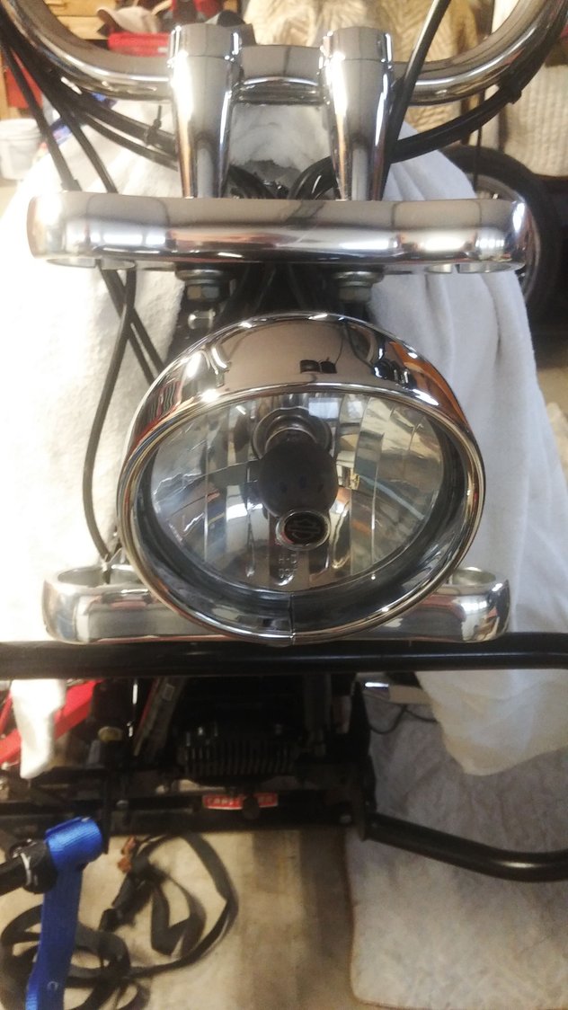

If you are using the current risers, you will need one inch bars and the horizontal section of your new bars should be at least as wide as the top tree so it looks symmetrical. I have your stock bars and risers on my super glide.

The stereo head unit is about 9 inches across. This is the measurements from Wild 1 for the standard 14 inch apes:
36.5" WIDE, 9" CENTER, 10" PULLBACK, 42° WRIST ANGLE
Sounds like the bars would be cutting it close in clearing the head unit.
