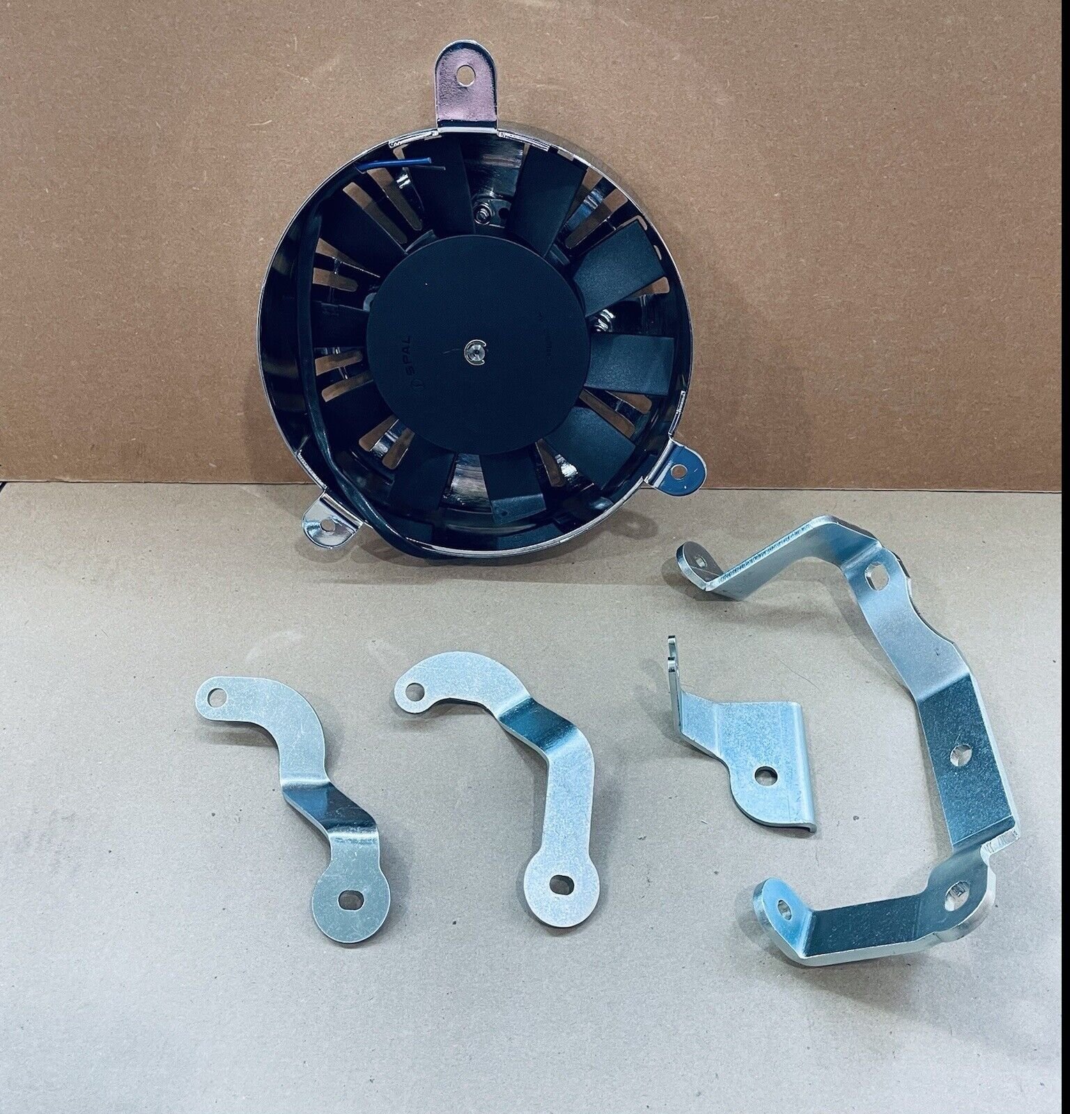

Sometimes sets like this pop up at Ebay
91552-00A Harley-Davidson Accessory Fan Kit Chrome Dyna Models
91551-00A Harley-Davidson Accessory Fan Kit Black Dyna Models
Link to Instruction Sheet
