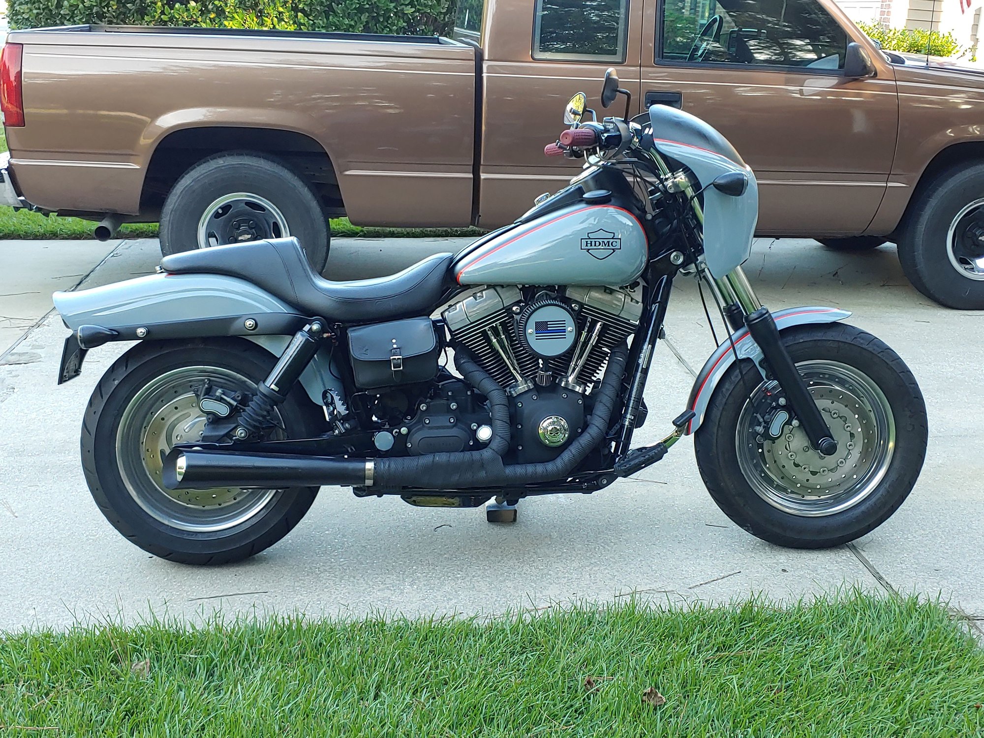

I have air shocks from an electraglide on mine. If I'm not mistaken they are taller than the rk shocks. My Fat Bob sits higher than with the stock shocks. I also changed out the oil. I run them at 20 psi. I've had them on there for a few years now and love them.

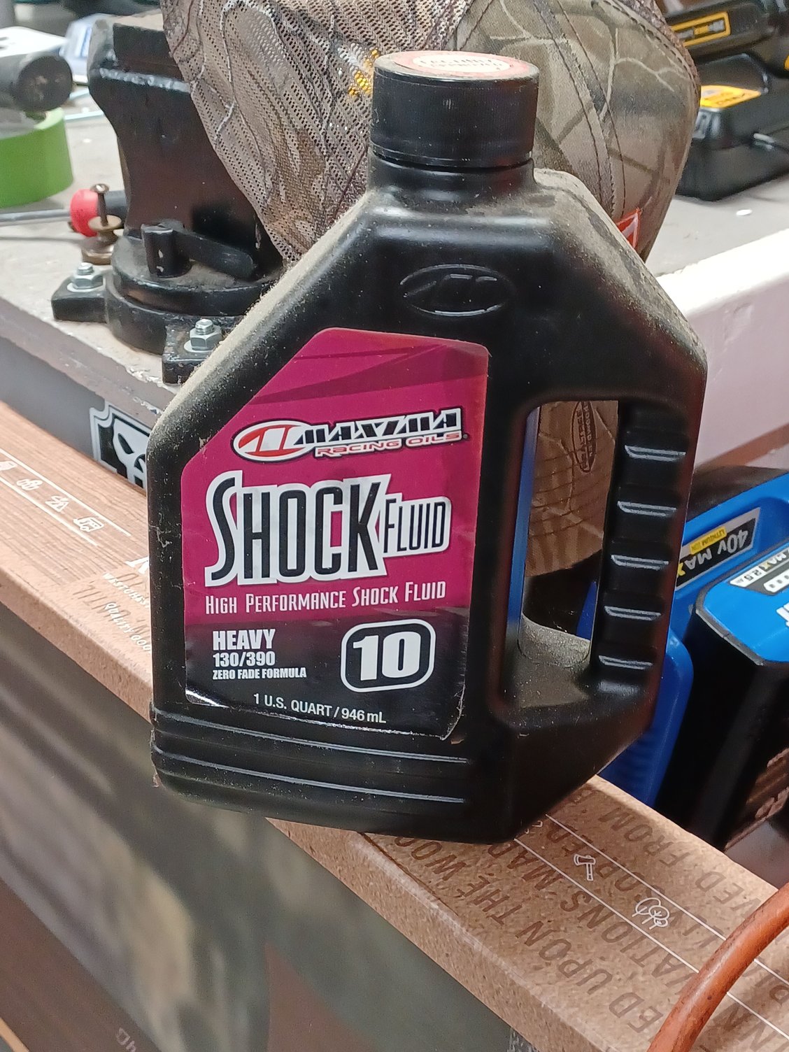

What I used...
