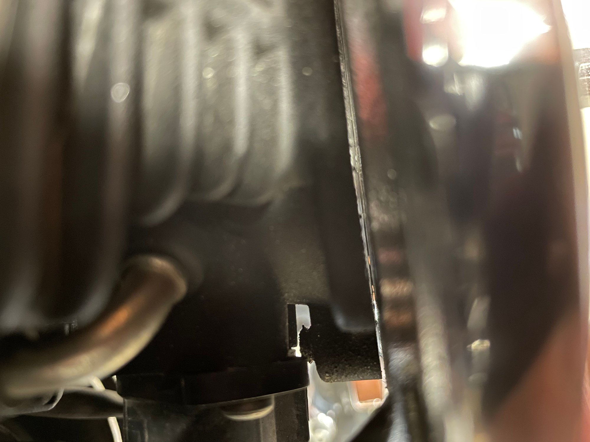

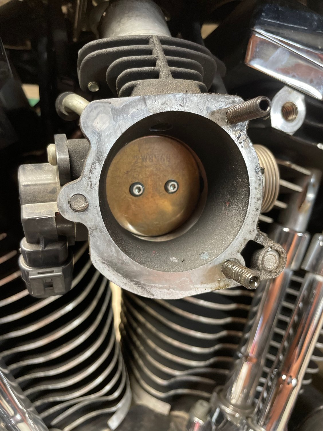

Well… I was cleaning the intake and degreasing the manifold (with the air cleaner off) and noticed a broken stud on the Arlen ness air cleaner that attaches to the throttle body! Which resulted in a huge gap between the two. It gets better, when I took it all apart, there were no O-rings on the breather bolt and no gasket in between the intake manifold and air filter plate. Called Arlen ness and they were killer dudes, I got a whole hardware kit on the way.

Well there ya go. An air leak like that can certainly cause some sputtering and misfires.
I'd still run some Seafoam through it for the next couple of tanks of gas just to be sure its good and clean.
