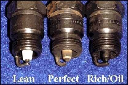

Old Jul 31, 2022 | 10:14 PM
baldric's Avatar
baldric
Joined: Jul 2008
Posts: 1,903
Likes: 3,133
From: Edmonton
Old Aug 1, 2022 | 09:06 AM

Oil fouled plugs will look like the picture above, wet and black. Plugs that have been running too rich will look more like they're coated with dry gray or black powder.
Originally Posted by Rounders
to really read plugs get it up to speed, and shut bike off.
This is called a "plug chop" and is used to check main jet sizing, but isn't too useful for long term trend analysis.
