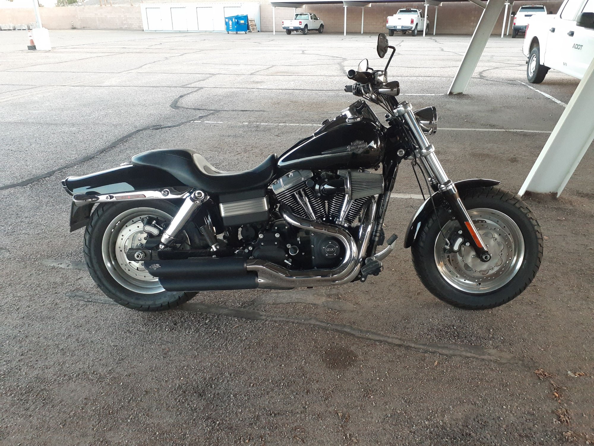

So, Ive returned to ownership of a Dyna Fat Bob! Not my first Fat Bob, and I got a darn good deal on it I think.
Thanks to Lets go Brandon's war on US energy, I tired quickly of filing my Diesel tank for $220 every 10 days. Hadnt been on a bike in 4 years, and hadnt been on a Harley for 8! Time to get back on 2 wheels, and I wanted another Harley.
I found and bought a 2007 Sportster 1200 50th Anniversary and it reminded me how much I actually enjoyed riding. While it was a fun bike, it was clear it wasnt nearly as good on the freeway at modern freeway speeds as a modern Big Twin.
I rreeaallyyy wanted a Dyna Low Rider S. But after a few solid weeks of research, I just couldnt get behind a SE110. Too much uncertainty and too many instances of hard failures. Plus, the Dyna S tax was still too much for me.
I found my Vivid Black 2013 Fat Bob at Roadrunner Harley with 20k miles. Previous owner installed a Heavy breather intake, Vance and Hines slip ons, Harley Mini footboards (LOVE THEM) and Daymaker head lights! I added the Reduced reach forward control kit because Im short. With the miniboards it feels very comfortable, even with the God forsaken factory drag bars. Just got the cables and hoses to install my 14" Wild1s which should make riding my bike 10000x more comfortable.
Plans are to pull the crank and get is adjusted and welded at Darkhorse and have the Dave Mackie Mega Sphere headwork and piston package installed. Probably next spring.
Love this bike!!!! Will get a pic uploaded tomorrow.

Finally snapped a pic. The blank canvas to start with!
