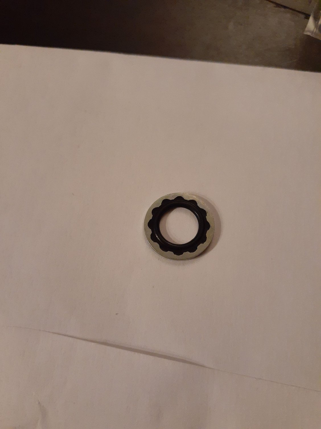

So I stopped by Harley to get the banjo crush washers for my ape hanger bar install. Per the parts counter, it listed 41733-88 as the banjo I needed x6. Here is a pic of one:
Problem is that they are obviously too big when holding them up to the ones Im going to be replacing. The factory parts look to be simple crush washers and not gasketed washers.
I haven't disassbled the bike yet, so I dont have an old washer to compare to. Does anyone have a correct part number for the washers Ill need? Thanks!

The last time I rebuilt a salvage bike, I had such a hard time getting M8 H-D crush washers, I went to Autozone and got a pack. All good 1K miles later.

Those are the new style and will probably work just fine with DOT 5 and 5A.
I wouldn't trust them with 3 and 4

DOT 5A?
If they are selling them at Autozone, there are probably a zillion of them out there on DOT 3 and DOT 4 systems...

I have used the copper crush seals that I bought at Automotive parts store and they seem to be working fine. No leaks and have been on for awhile now.

Copper crush washers should work fine, available at most hardware and parts stores. Try to find one that has them individually, otherwise you'll end up with a pack of 20, only 1 or 2 of which will be useful.
The part in the photo in post 1 is called a "Stat-O-Seal" or "Lock-O-Seal".
