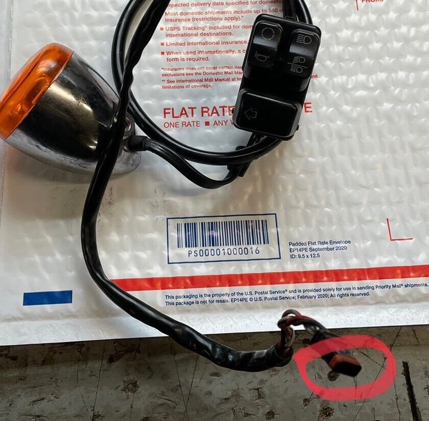

I accidentally tore the rubber connector seal while swapping out risers last night. There is no part # the rubber seal itself.
Anyone have any idea where i can obtain orange rubber seal for left control switch connector? Not looking to buy a whole new switch just for rubber seal.

Maybe you can find a used cable on ebay or somewhere and use the seal from that. Another way to go would be a light application of silicone, it should seal find and be removable.

Silicone and then after it's dry and put together i would rub the outside with some dielectric grease.

If you can't jerry rig the one you have you should be able to buy the connector housing and de-pin the one you have. It's a weather seal, so if you can find another way to keep water out you should be fine.

Here's a link that might help you finding a connector...the H-D p/n is 72908-11
