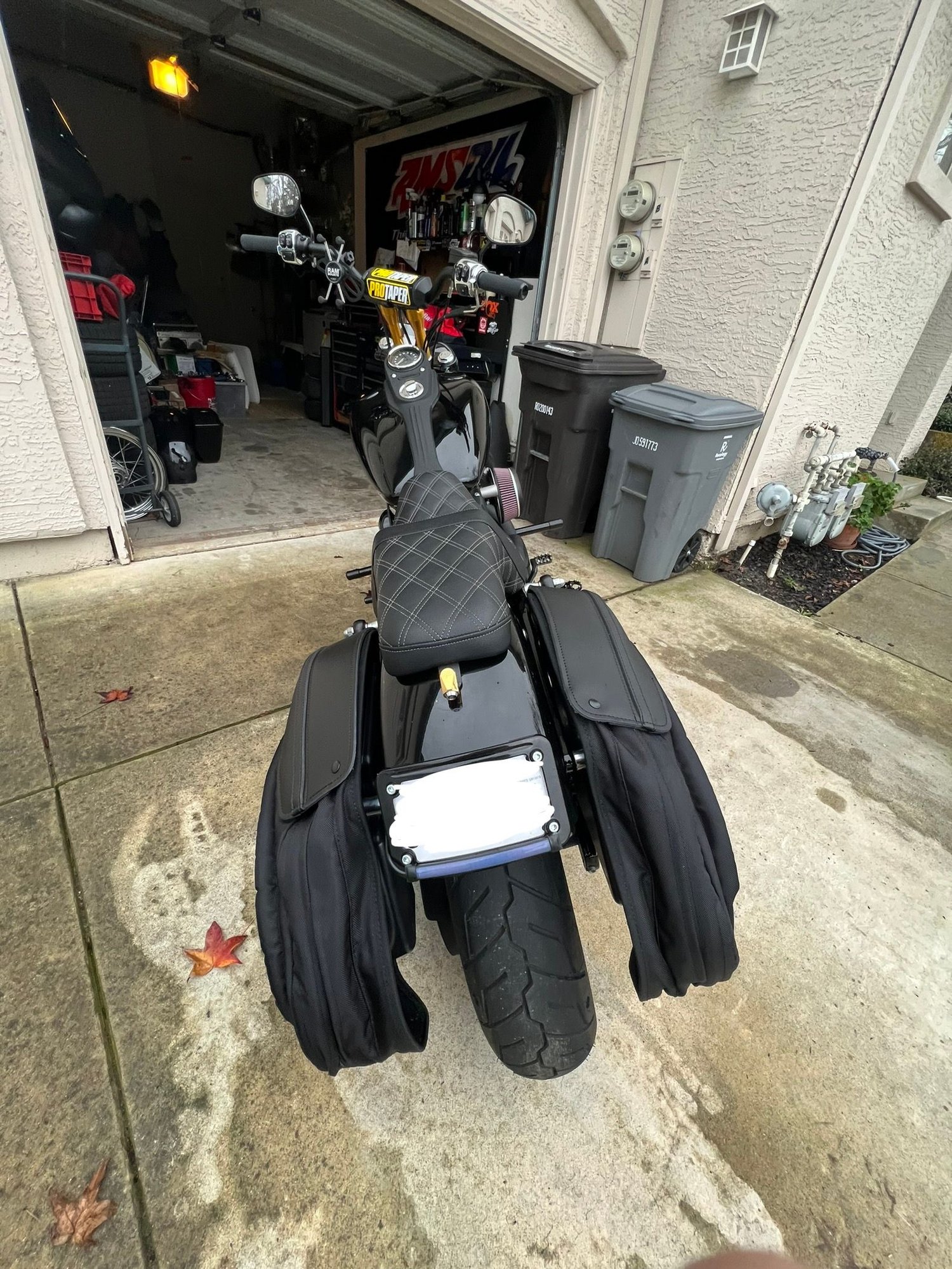

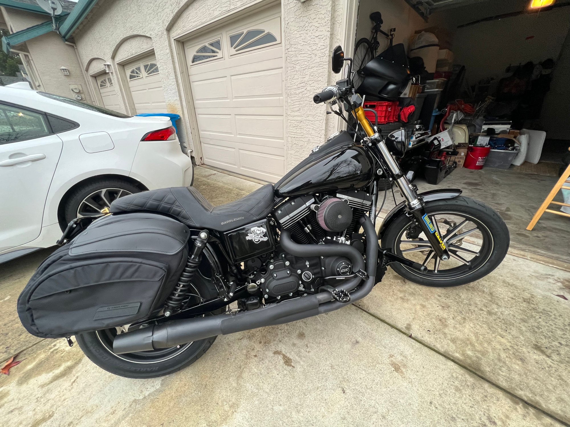

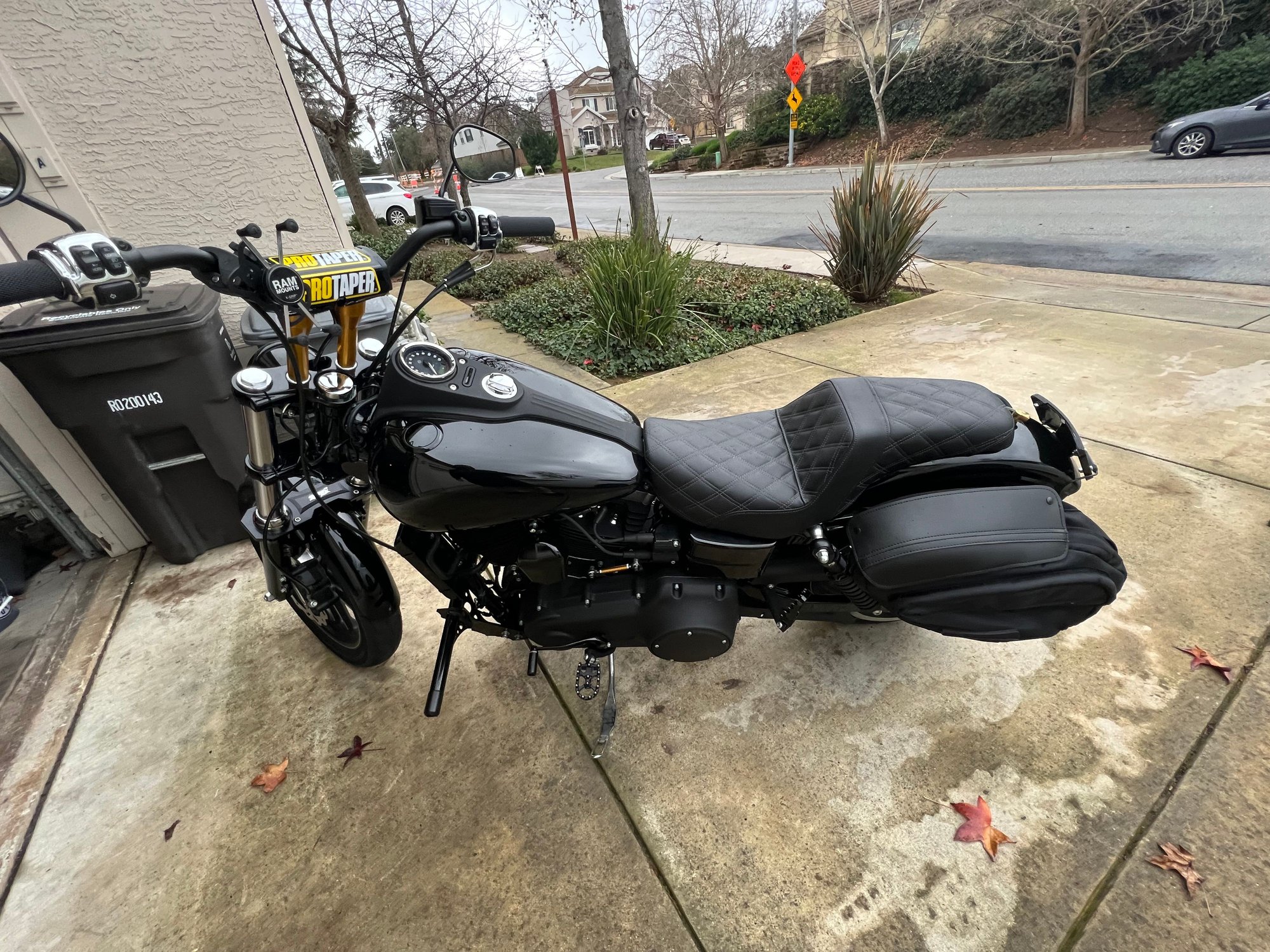

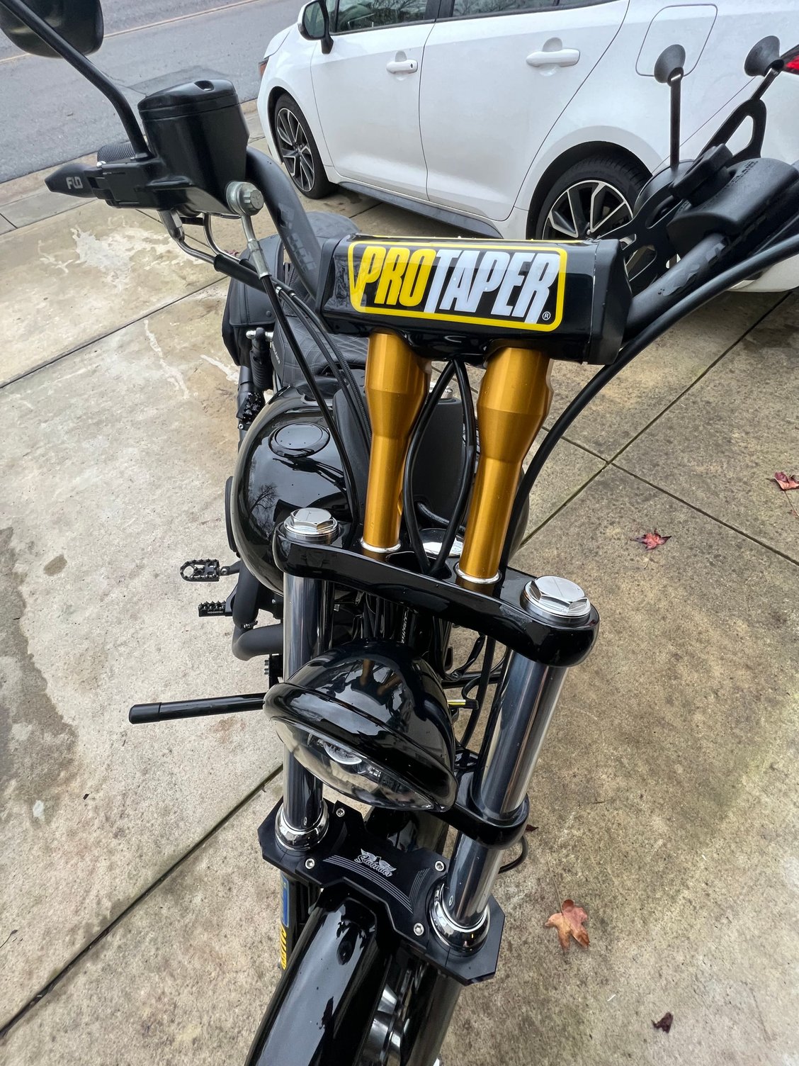

So I'm curious to see what kind of upgrades people have done with their bikes, and hopefully figure out some other stuff that I would want to do to mine. I have a 2013 FXDBP and I've done a handful of things to it already. 13.5 Fox in the rear, heavy duty progressive front springs, fork brace, put the OEM rear fender back on and wired up the lights for that since someone had installed a switchback rear end and I wasn't feeling it, I also installed Galfer rotors, 7in hardcase risers w/4in ODI handlebar, seat, thunderheader and high flow air cleaner ( should I keep the thunderheader installed or go with something different? From a performance perspective? )and thats about it. I work at a harley dealership and was told when they test rode the bike after changing the rear tire that it may have cams installed but I honestly have no idea. It is setup like most generic dyna bro dyna's. I'm more interested in what everyone recommends or has for handling and performance upgrades though? I want to keep the bike reliable since it is a daily rider and I have to work around California's BS carb laws somewhat, but definitely want a little more power and a little better handling. Any recommendations? Thanks!
