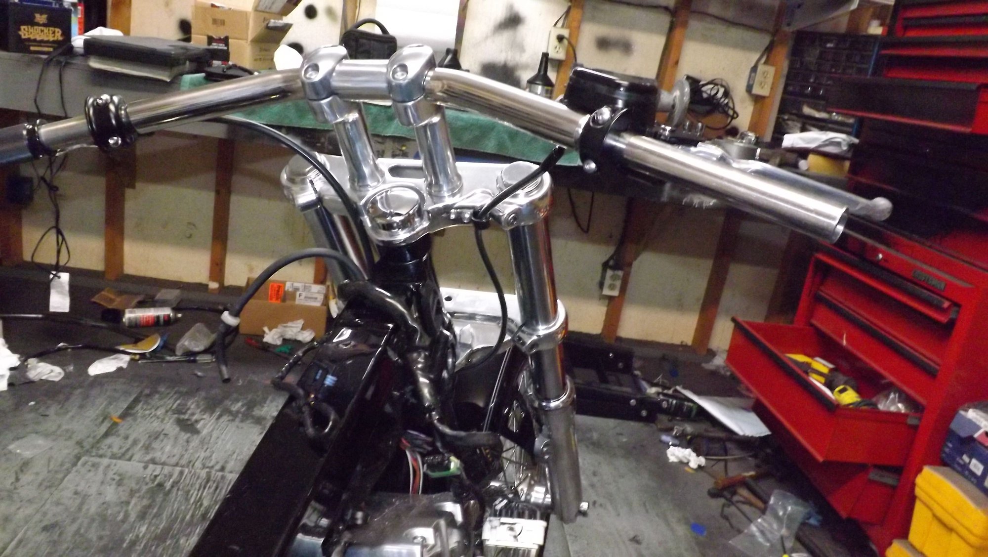

There is nothing I can do right now, yet I did install these Joker Machine mirror plugs to fill the holes that will not be used.

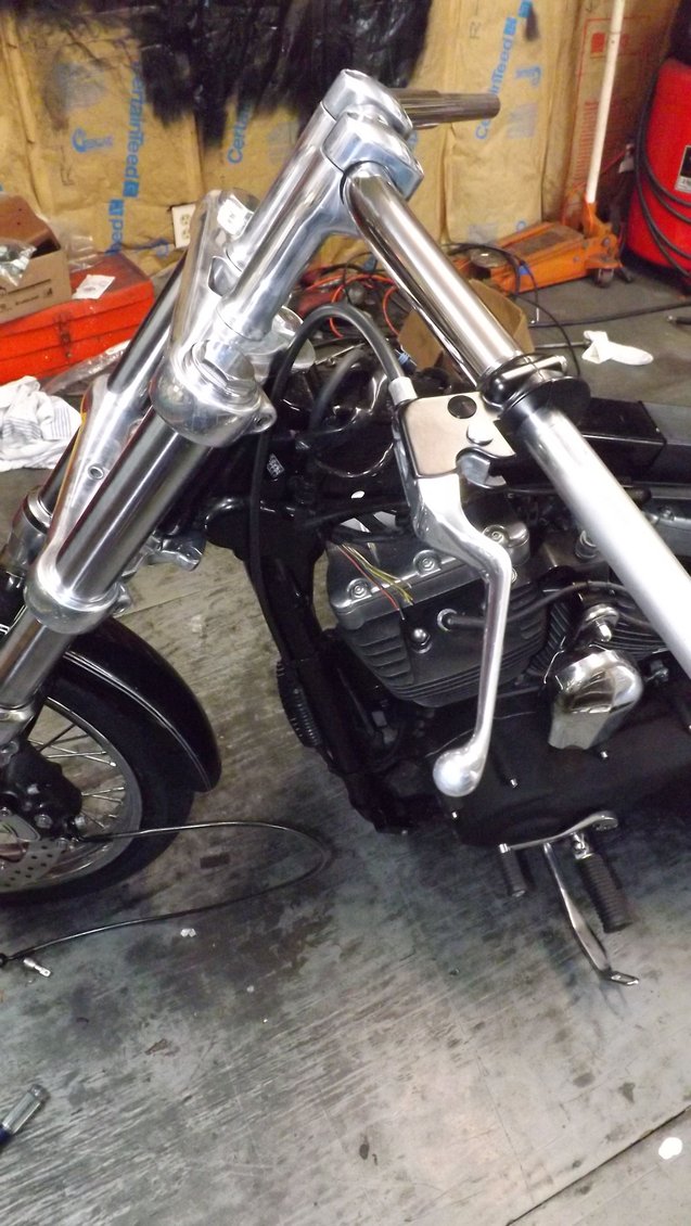

Probably not the look you are after, but I was shocked at how much more comfortable those bars became when I angled them up.

Aye. How tall are you? I'm 5'7".
I am not certain where they will wind up being adjusted to. They feel good now where they are just by sitting on it. A road test will surely tell the tale.

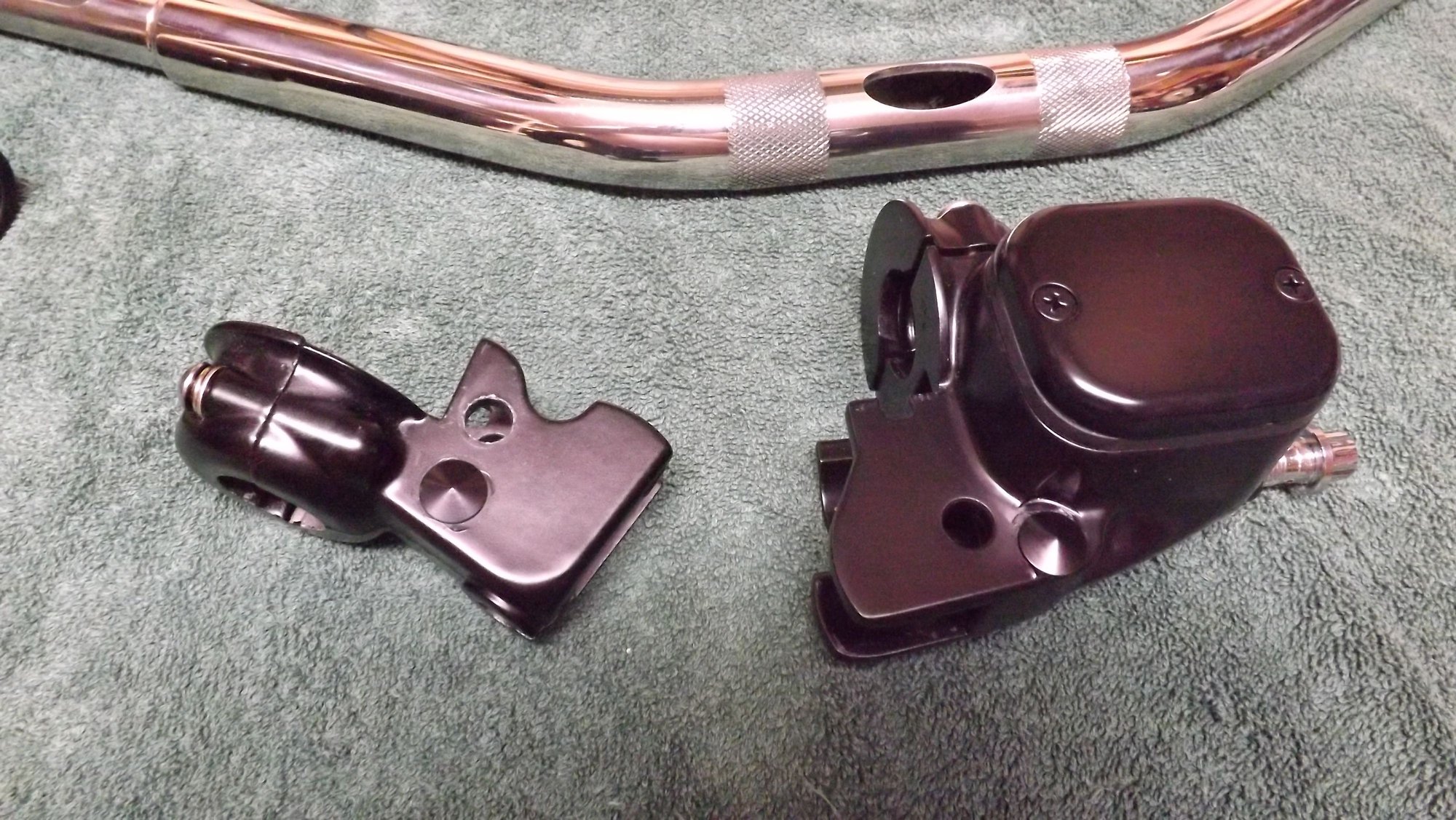

PS: I'm working on the front brake master cylinder and line tonight.

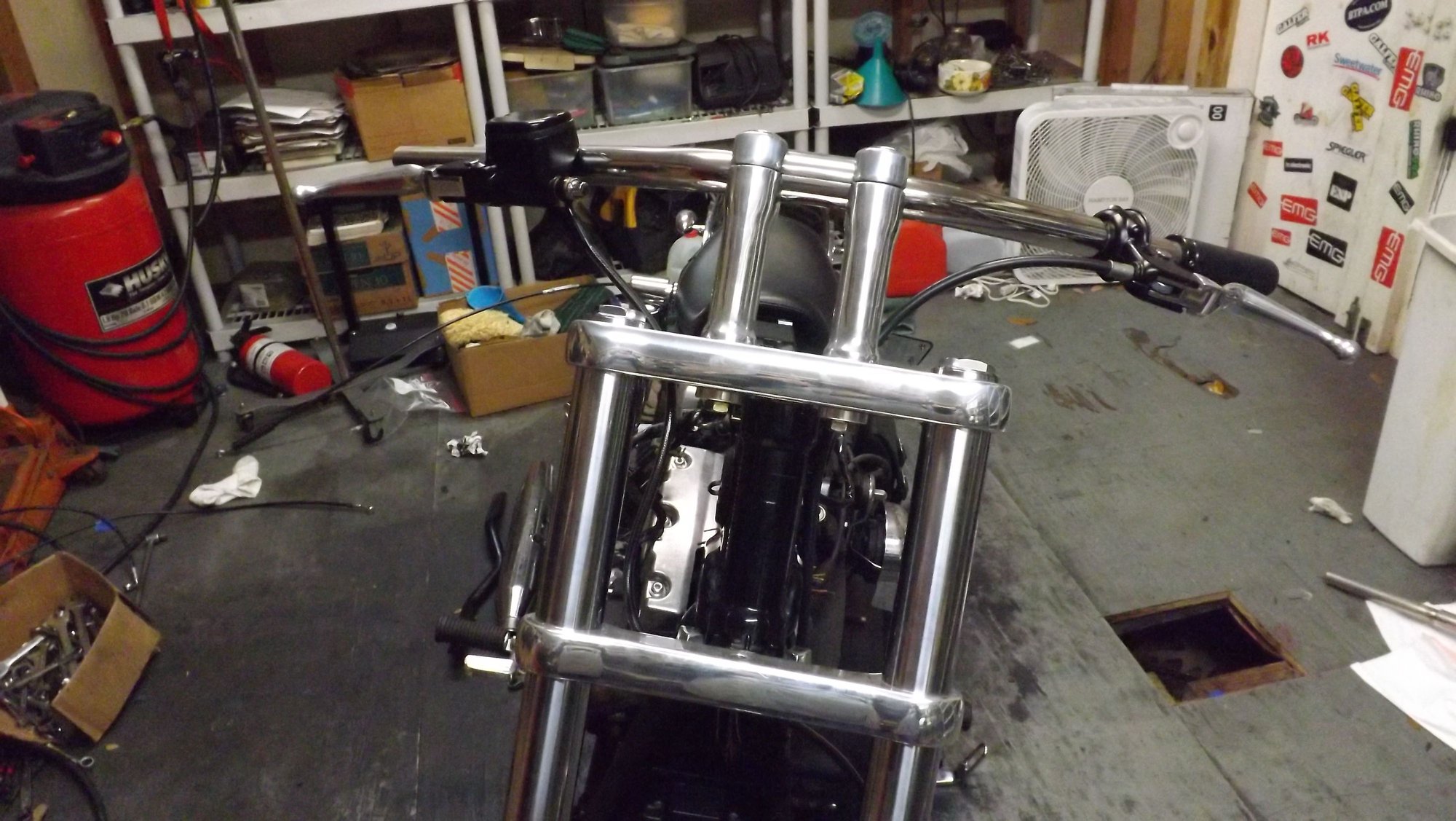

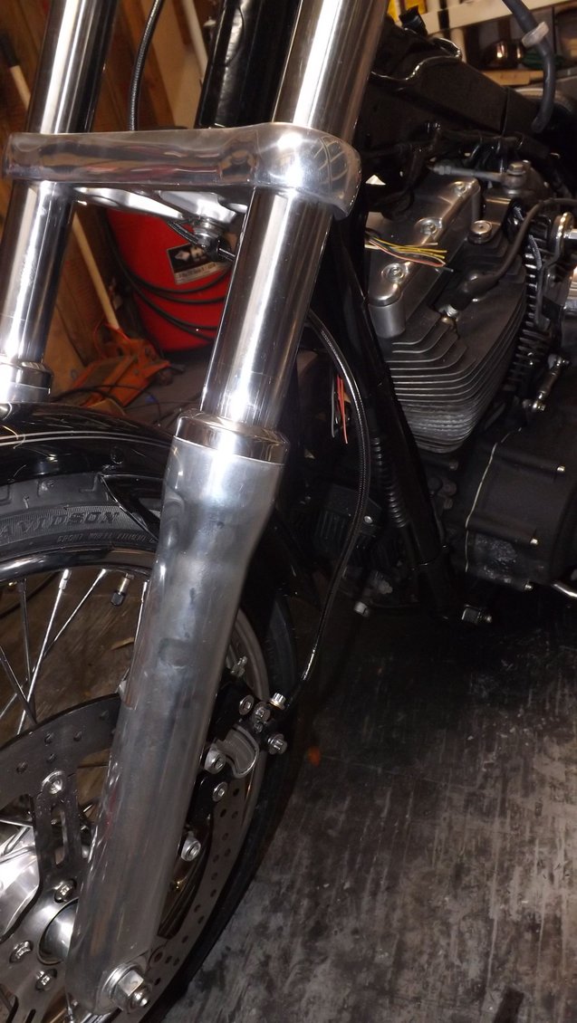

Update: the front brake line is installed, filled, and bled. The bike now has front brakes. You can just make out how the line is routed in these pictures:
The bike sure needs a good bath and detail. I'll continue the detail process later in this thread. Thanks for looking!
PS the front brake line is a 38" long Magnum front brake line - an awesome fit for these drag bars:

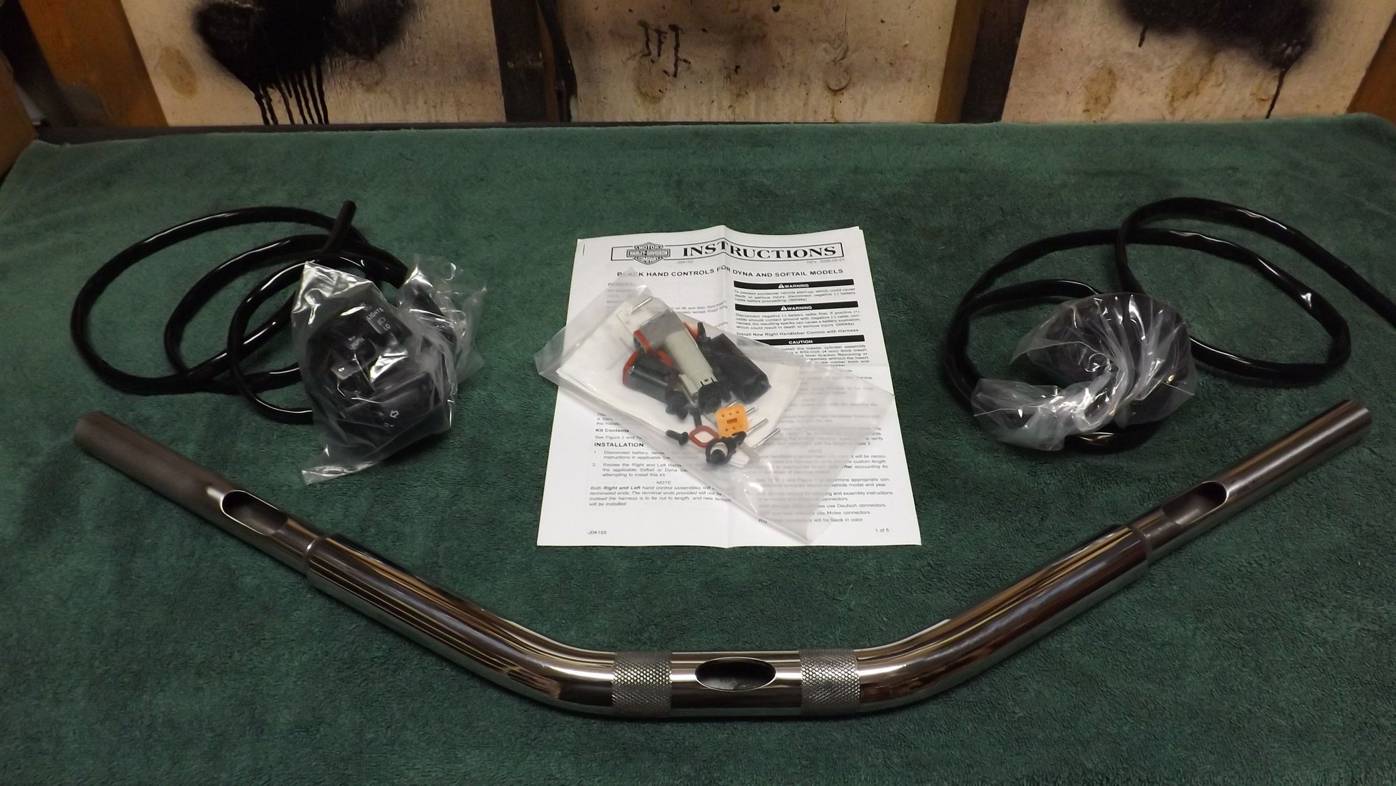

The Harley-Davidson prewired handlebar control switches arrived today. I will start on this next:
I'm not messing with the Harley plugs. It will be hardwired and soldered.

You might want to seriously consider using the plugs/connectors. If for some reason you need to pull the bars, a connector is easy to take apart. It's fairly easy to just remove the pins from the connectors. Well as long as you know how. My manual shows how to take them apart.
JMHO,
