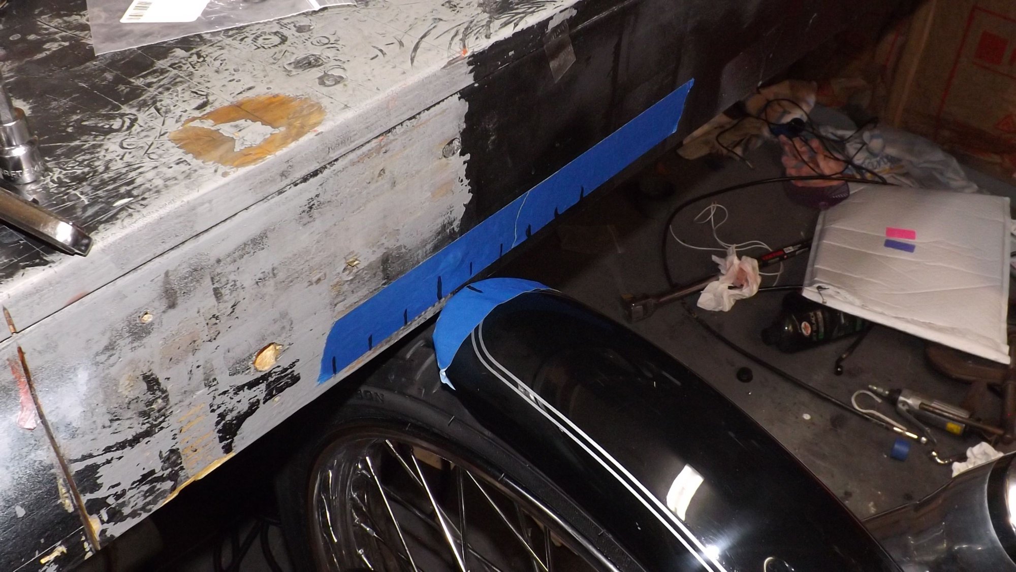

Messing with the fall away test. The disc side just falls away immediately. The other side falls away at about 5 inches.
I'll tighten.
