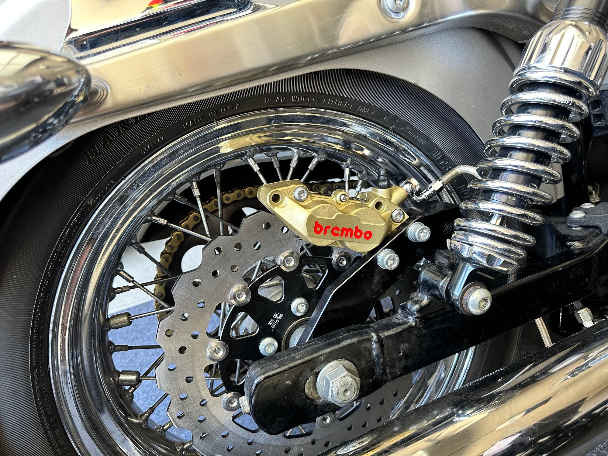

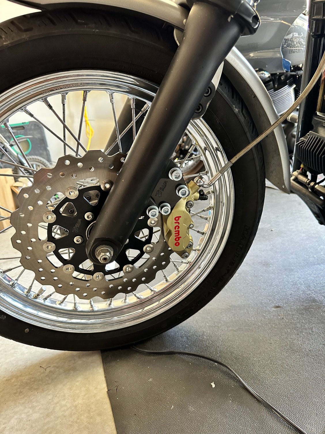

So Bareknuckle is running a 25% off sale for the 4th of July and I took advantage. While I had planned on getting a second chopperhauss rotor up front I was really on the fence about spending any more money with then as I have had some issues with their parts in the past. I decided to get the antihero 13" rotors for my dual disc conversion and a matching rear in 11.5 obviously. All that's left to buy are my M4 calipers!

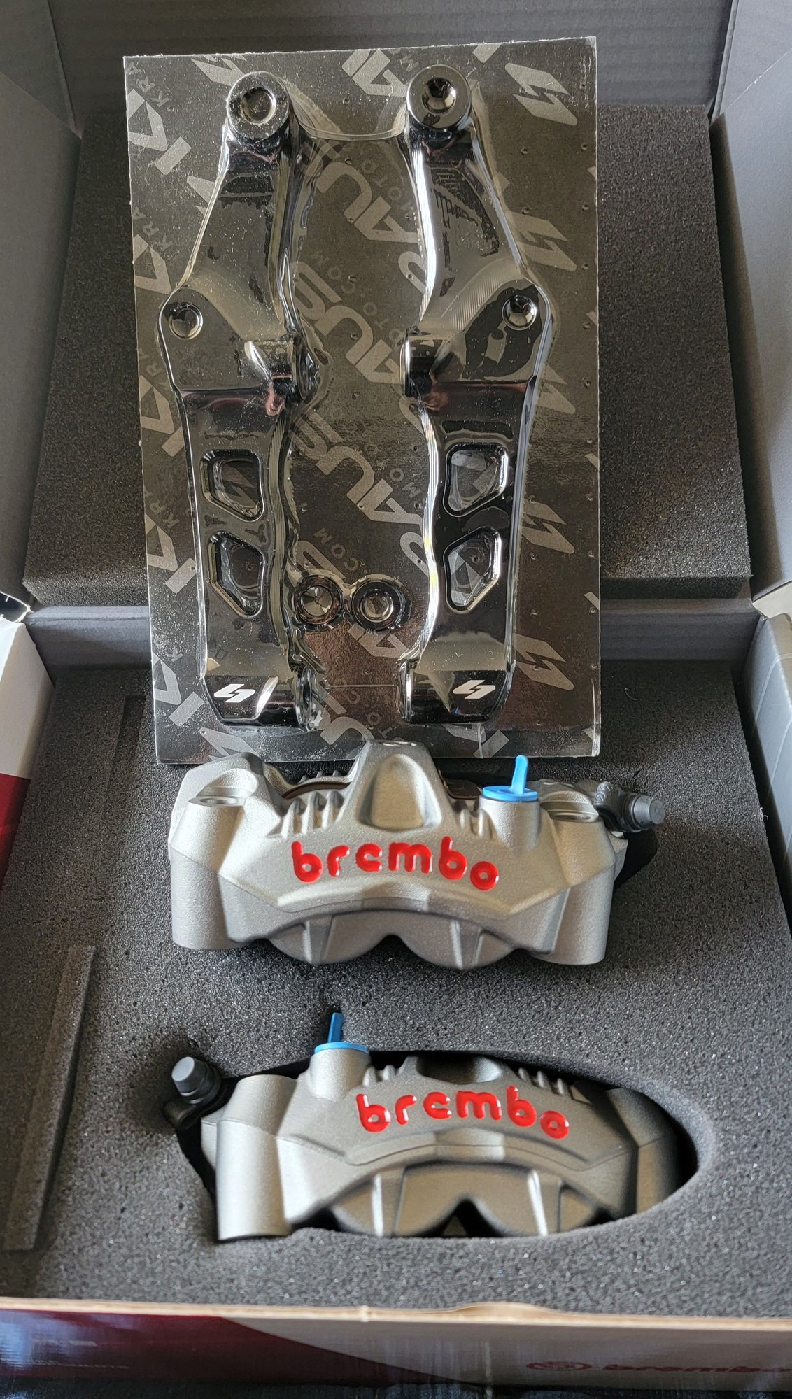

Brown Santa brought me a present yesterday (finally!) ...fresh from SpeedKings a pair each of Brembo GP4-RS's and Kraus axial to radial brackets.
As a follow up on my front forks, I am going to get a set of Bitubo's to install this winter. The adjustability looks like just what I want. The more I ride my current setup of RaceTech springs and gold emulators I find them to be jittery on bad roads at speed. They don't really feel loose or unplanted, just f'ing irritating. It's all front end work this coming winter, these Brembo's, the Bitubo's, flush axel from Green Brothers and I think I'll throw a fork brace on while I have everything apart again.
