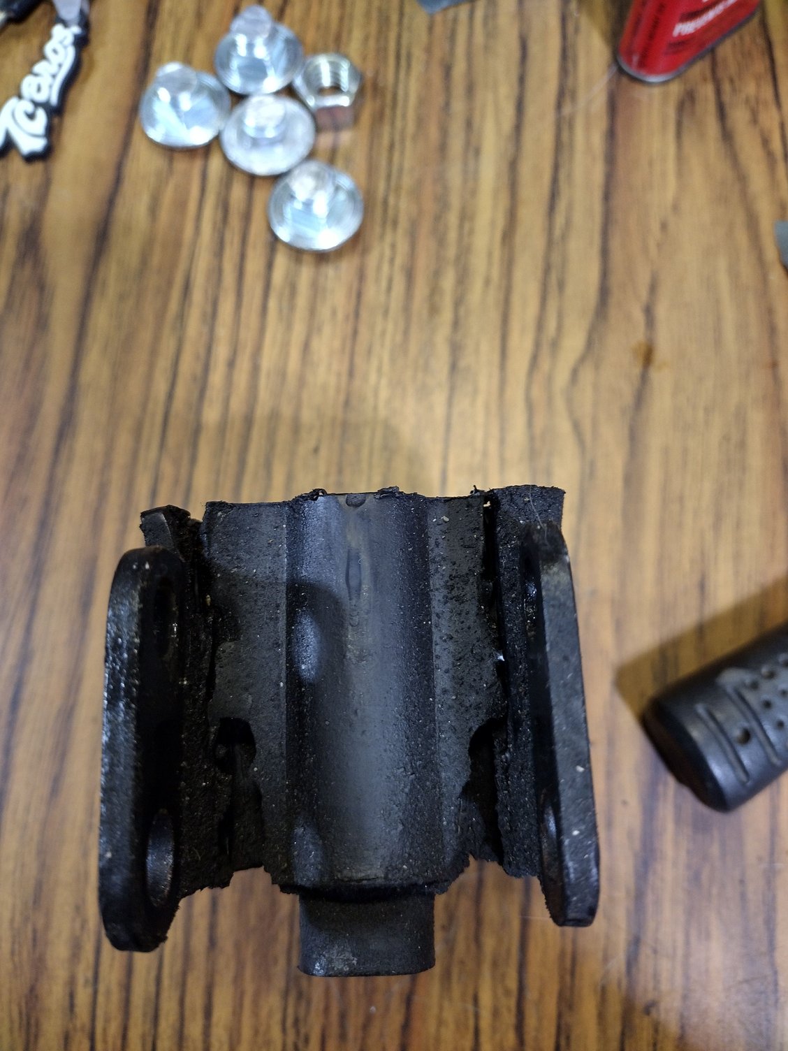

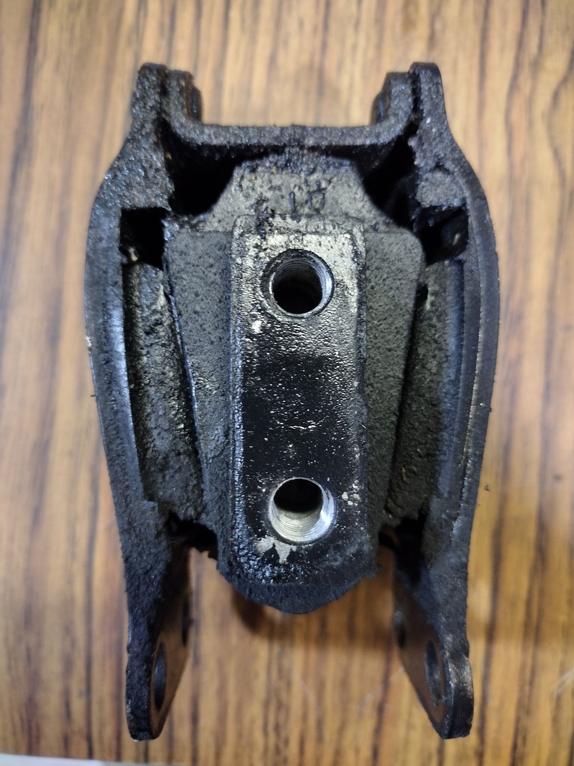

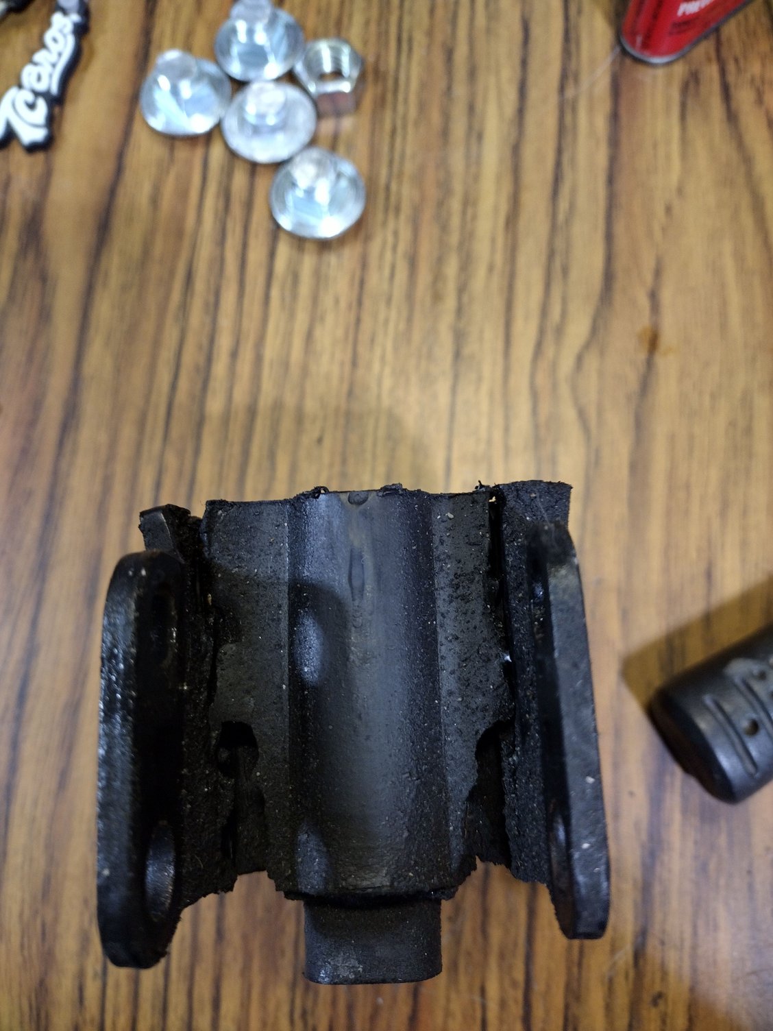

Installed a Drag Specialties front mount, Kinetic Structures rear.
Front mount was trashed, rear, not so bad.
But figured that since I was into it, I might as well replace both.
I kept the OEM rear as a spare , just in case".
Front
Front
Front
Old Sep 30, 2023 | 10:50 AM
KentuckyChristian's Avatar
KentuckyChristian
Joined: Oct 2022
Posts: 379
Likes: 813
From: Kentucky
Default Update.......
Replaced both front and back mounts.
Drag Specialties front, Kinetic Structures on the back.
The initial ride was as rough as a Cobb, except for a sweet spot at around 2,500 - 3,000 RPM where it smoothed out very well.
Each subsequent ride seems to break in a little bit at a time.
Even with solid riser bushings, there's little to no perceptible vibration at 3,000 rpm, where most of my riding takes place.
