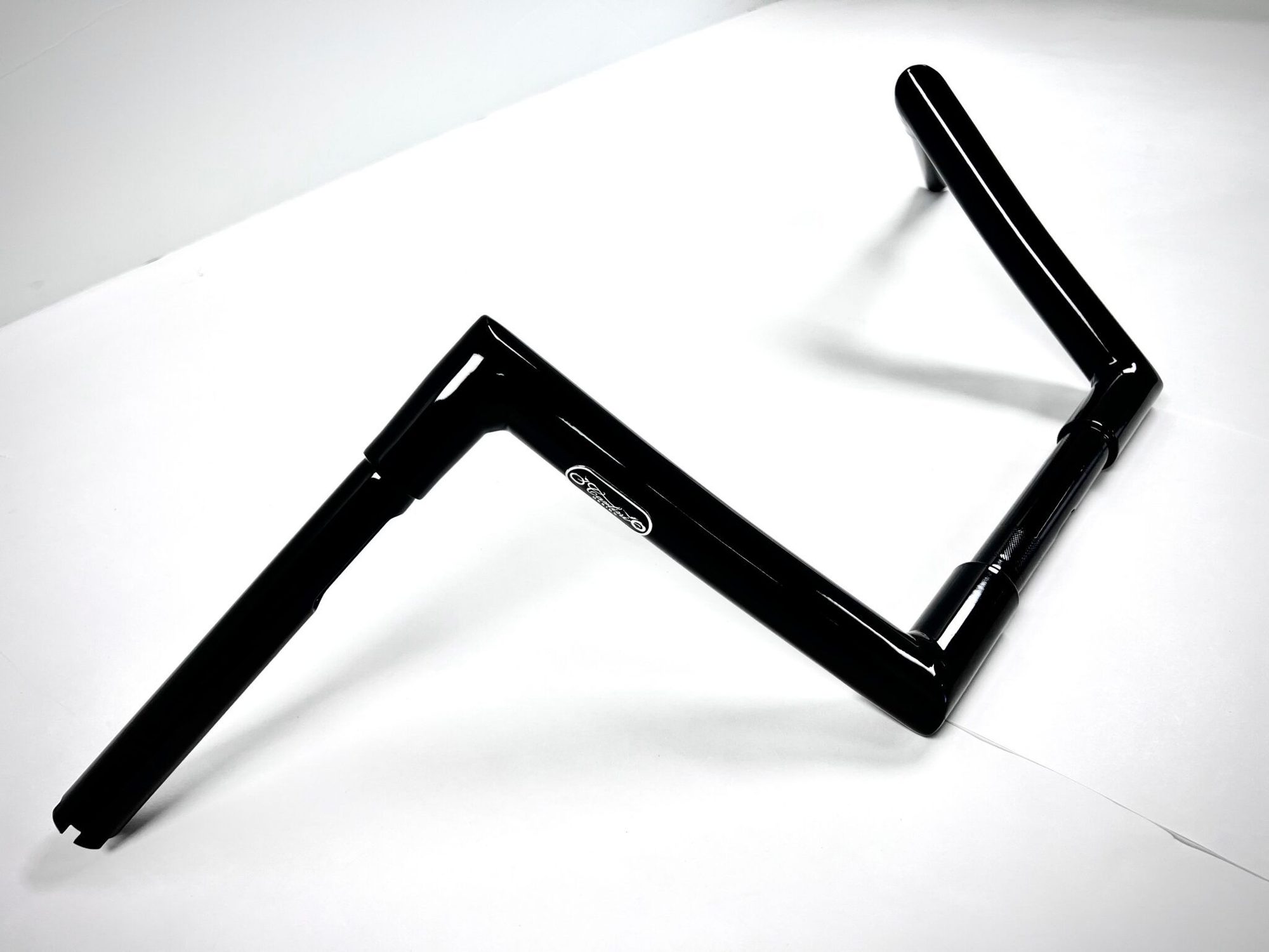

Last year I bought my 2010 FXDWG. It's a great runner and I've had no problems with the bike itself. It came with a set of 10" Carlini Evil Apes. Since I prefer standard bars, I found a stock set of Dyna FXDWG bars on eBay and swapped them in. I had no problem installing the new bars but when I tried to remove the internal wires from the Carlinis, the wires themselves slid out of the heavy black plastic casings that the PO had used. That left the casings locked inside of the apes with no apparent way to remove them. Note in the picture attached that there are right angles in four places on the bars. That seems to be the problem.
I had wanted to sell these bars but I can't do that with the casings inside because the new owner wouldn't be able to get his wires in with the old cable housings in place.
So my question is: Does anyone have any ideas as to how I could remove these casings? They are on both sides of the bars. I'd sure like to clean these out so that someone else could use them but otherwise they will go in the scrap metal bin. I've tried to fish them out with needle-nosed pliers but no cigar.
I also phoned Carlini but they don't take calls. They request an email. Thanks in advance for any advice.

Hi, thanks for the response.
I unpinned the connectors and pulled the wires out of the bars. The tight corners have grabbed the casings and prevented them from coming out of the handlebars. You can look inside the bars and see the ends of the casings but they are too far in to reach. There are apparently some sharp edges in the corners that have locked the casings in.

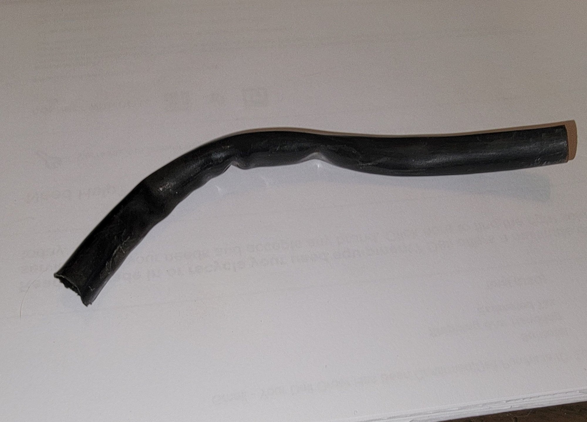

Originally Posted by ridingout
What about using long needle nose pliers grab hold of the end start twisting and pulling out.
I tried that on one side this morning just for fun and managed to remove a short section of the covering. That stuff is rather hard. (See picture), That left another piece in a blind section of the bars where it's completely inaccessible. LOL
I've determined that I will likely bore a 1/2" hole at the apex of each 90 degree angle. That will expose the remainder of the tubing. Bear in mind that there are also three other holes in the bars: One in the center where the wires come out and one one each side where the wires enter the control switch pods.
I'll drill a 1/4" pilot holes on my milling machine and then finish the holes with a 1/2" Ball mill so that the holes are very clean. Then I can reach the remainder of the casing material with a wire hook. The holes will be plugged with rubber plugs that I already have in stock. Necessity is the Mother of invention.
