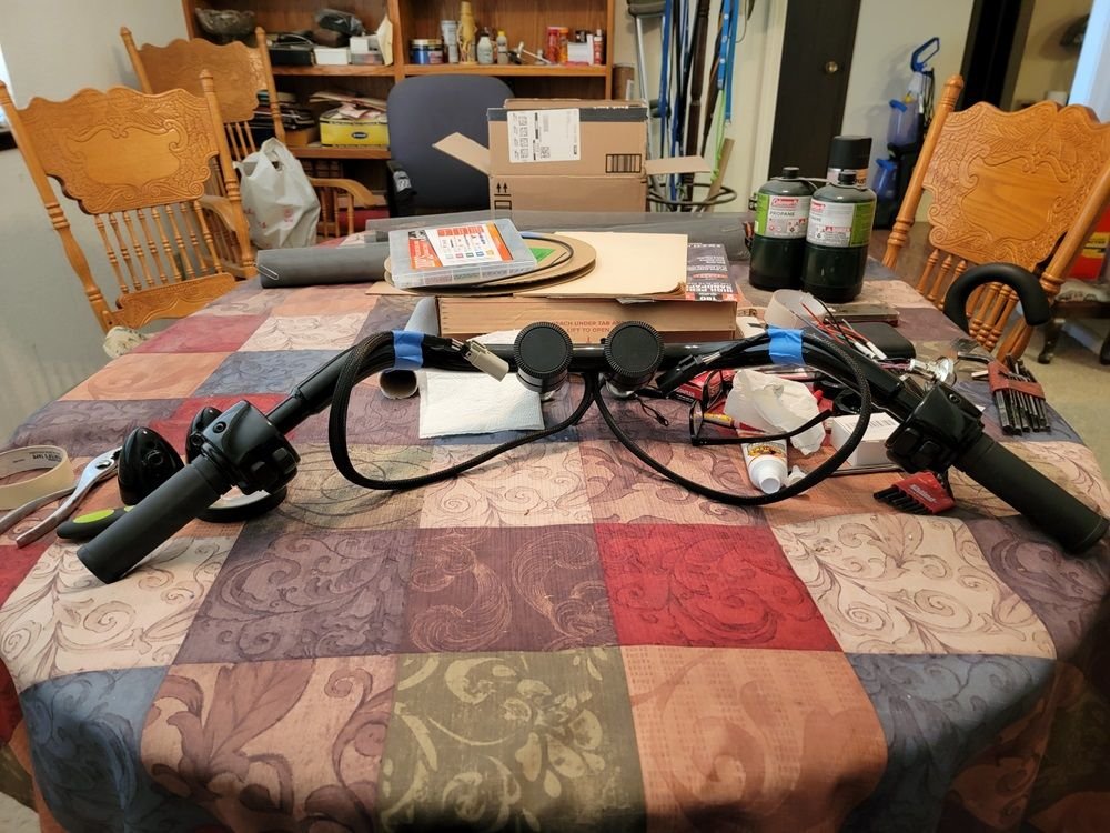

As mentioned above, I managed to remove a section from one side of the bars and that gave me some hope! I've learned from this problem that we should not use hard casings when installing wires in ape bars. It would be OK to use soft black nylon casings that would pull right out when removing wires. Maybe best of all would be to install the wires without casings since the chance of a short circuit is minimal due to the fact that the wires don't move once installed.
Here are pictures of my present job. I found a set of stock 2010 Dyna bars on eBay. I used 3/8" black nylon casings and they went right in since the bars are almost flat and they are 1-1/4" anyway. I've also used the Carlini El Presidente risers that were on the Apes when I got the bike a year ago. These bars will go on this weekend and then I'll be back riding again! I'll continue to work on the Evil Apes until they are clean and then they will be sold.
