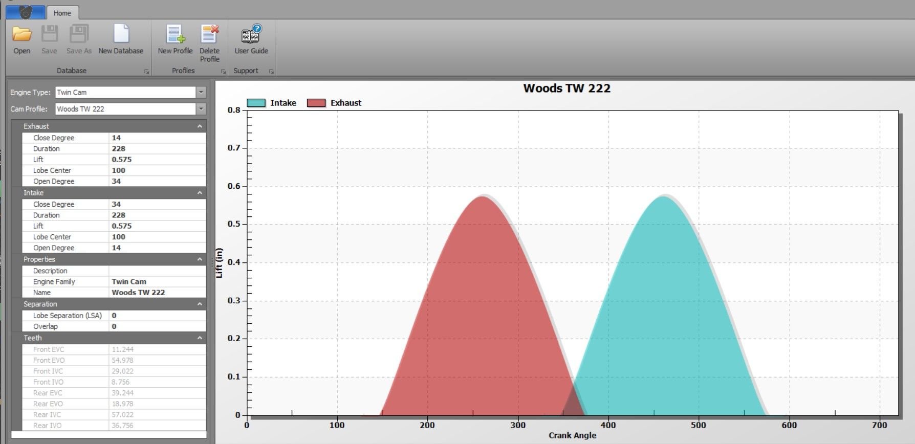

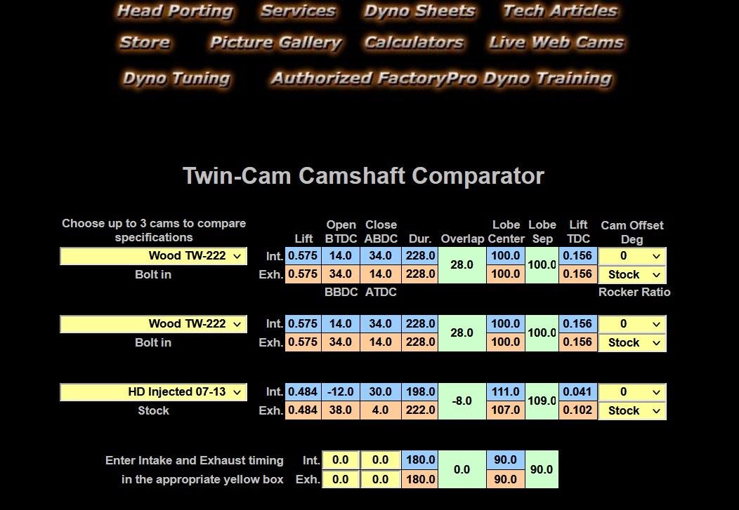

What is the actual lift on a Woods TW-222 cam? The spec that I believe is .555, but I have seen published on both the Dynojet Cam Cruncher app and and Bigboyzcycles Cam Comparator the lift is .575... My logic is telling me that Dynojet has a typo in their Cam Cruncher database and the Bigboyz site is pulling their spec from that database, but these are fairly popular cams so I feel like someone would have noticed this long ago and updated the spec. Wood Perfomance publishes a .555 lift for these cams.

Go to the source at Bob Wood's site. He says 0.555".
https://woodcarbs.com/cam-shafts/twin-cam/
It's unlikely that Big Boyz gets there info from Dynojet. Big Boyz has had that cam data up for years.
