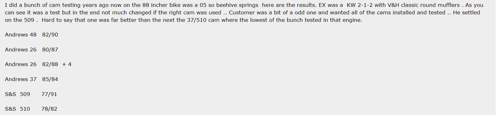

This is old and I did not do the testing but the test results of the most commonly selected cams for a stock or Stage 1 TC88; draw your own conclusions. You have to remember that these are peak numbers. The test would be more meaningful if the tester would have included the dyno sheets. Seeing the torque curve would be as important, maybe more to some, than knowing the peak numbers.
