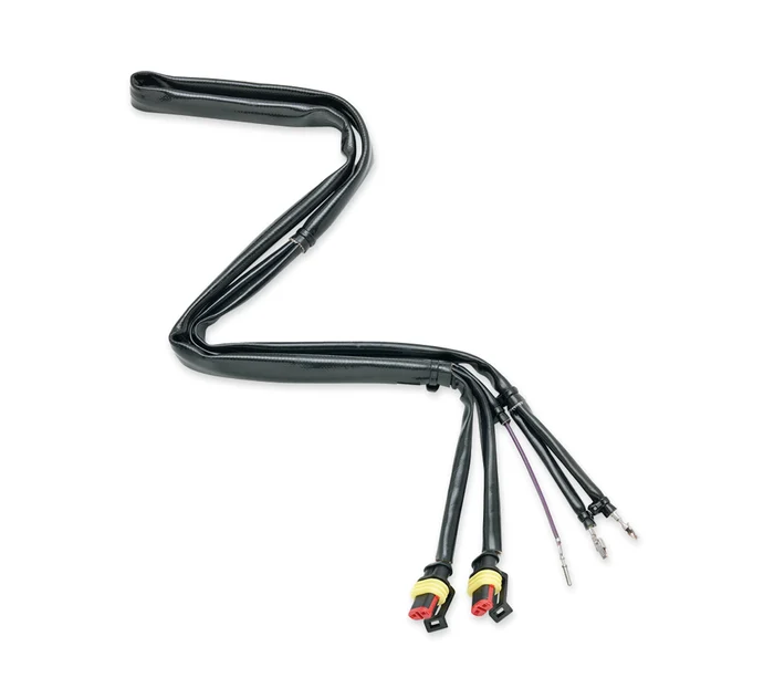

You need this wiring harness to add them. You'll also need to have the ACR function turned on in the ECM. A dealer can do it, or if you have a PV or TTS tuner for that bike they both can activate the ACR function.
70623-06 - Screamin' Eagle Automatic Compression Release Wiring Harness
https://serviceinfo.harley-davidson....0_en_US.blaise

For the acr's yes. Take 2 of the wires from the ACR's and connect them to a wire and run it to the wire that goings into the starter for the solenoid.
Take the other 2 wires and connect them to a wire that runs a ground post usually on the frame of the bike'.
The ground point I used was just behind the gas tank on the frame. Easily seen with the seat removed.
Your bike maybe a little different ya just gotta look and see.
Opps I did put an inline fuse in the wire that goes to the starter. 10 amp if IIRC
