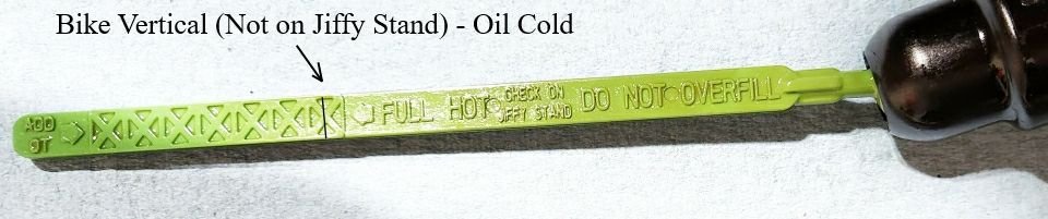

Ok, 71 years old (52 years riding bikes) and I am asking this? I must have dementia.
My 2009 FXD has been in storage several months due to me cracking a Vertebra in my back in half. Tired of waiting to see what the Veterans doctors might do, so I am ready to ride. (This will change my back - not sure for the good or bad, but I am sure things will change).
Anyway, I lost the little note paper that told me what the "Full" oil reading is for a Dyna placed straight upright (Not on the Jiffy Stand).
You see with a sidecar, the Kick Stand is a bit useless.
Anyway....was hoping one of you fine Dyna owners would go out to your bike. Check that the oil is full (by using the Jiffy Stand), then put your bike in the upright (level) position and check again. Take a picture, draw a picture, or otherwise explain what you see. Presently I read just below the top most "cross x" on the dipstick. (On your dipstick is imprinted a series of what looks like x's. My reading is about halfway down on the second from the top - but again the bike is straight vertical)
I am sure hoping someone can do this pretty soon as I am not getting younger and the weather is 72 here in AZ today. Hey thanks in advance.

First "X" below the "full hot" line. About half way in the "X" on jiffy stand hot. On bike lift with bike upright, it was just a hair over/on the Full line. If your in the middle of the second "X" down when hot, you should be fine.
Remember this is when the oil is hot from a ride.
Hope this helps.

The mark if your dip stick says on the stand is calibrated so it's not to high on full mark when hot.
Once it's hot, as long as you don't fill it over the full upright, your good.
That's what I would do after a oil change. That way , it won't appear too low before next oil change.
Does yours not look like this?

Jackie Paper. Thanks for the images. I did not know there was a dipstick with jiffy stand or upright marks.
Tom
Tom
There so many varieties, it's staggering. Personal, the stand nonsense just made it worst. Especially if the bike is lowered.
Like Dan says in his typical good mood, check the owners manual. But just make sure bike is not lowered or other suspension modifications and your stick matches the manual.
The one in my Softail is Harley's analog temperature stick. Has a circle line at bottom and another circle about a inch up. It's just a round unmarked one.
And if you don't have a owners manual, Harley will loan you an online one at harley.com.
Not sure if instructions of first posters owners manual applies to a sidecar. Is that a option from the factory or does a dealer add that on? Only factory side car I have seen was a FL full size cruiser.
Most owners manual for Dana and Softail say to not put a side car on them. Least I read that somewhere do to safety reasons.

Thank you all so far for your replies. The info really helps. I had it all written/drawn once, but it must have gone out with the paperwork when I donated my Kawasaki 650 offroad rig to a Veterans group that gives sidecars to those in need.
I may be overfull? I am pretty sure (Like Tom H says) that it will be higher with a vertical bike than on Jiffy Stand. Can anyone confirm the "Cold" readings? This is where I am....
