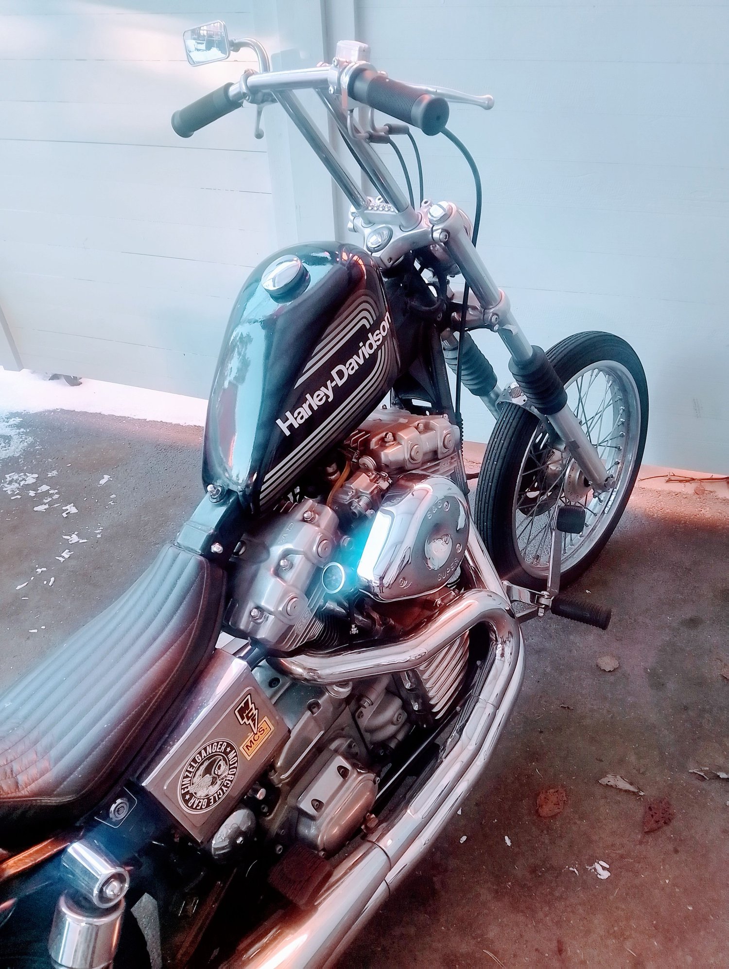

Hello all,
I would like to swap my spoke wheels for mags, for a change of looks and to be able to run tubeless tires.
For the rear I have bought a 17x4.5 Softail Deuce wheel but for the front it's more tricky. I am aware of the various 19" mags from Sportsters and Dynas but I would love to continue using a skinny 21" tire.
So here is the long awaited question, does anyone know of a 21" mag wheel that will fit in the narrow glide front end?

Well, that CVO Deuce wheel won't fit, but HD did offer that same "Slotted 6-Spoke" front wheel in a 2000-later narrow glide version.
Yeah @Crazy there were several different 2000-later 21" narrow glide front wheels through HD "Parts & Accessories". I don't remember any for the 99-earlier though.
@SwedishMeatball , are those a 00-later sliders? It looks to be, but hard to see from the other side
Yes, bike is a 2002 so a 00-later wheel will fit.

Quick update, I found an online catalog, and then found the wheel I want. "Detonator" 21" wheel for narrow glide, part #44661-07
I think that would look really cool on my bike. Maybe bead blasted to a raw alu finish.
Of course totally impossible to find on this side of the Atlantic and shipping plus VAT will make it crazy expensive to buy from the US of A. Let's see what can be done
