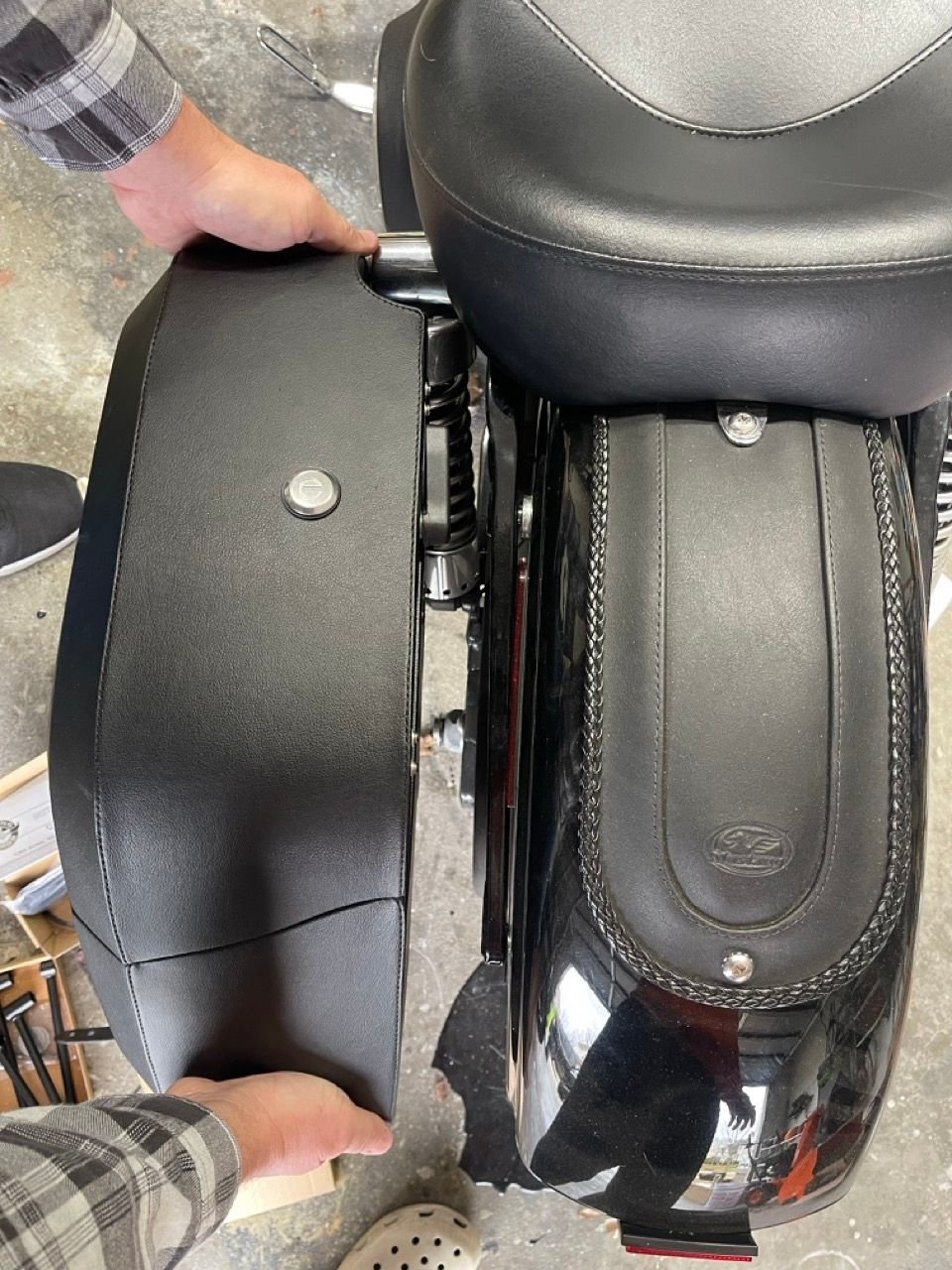

My wife has a 2016 Dyna Street Bob and she decided on new bags. She ordered bags off of Vikingbags direct with shock cut out. They arrived and the gap behind the bag to where the rear fender is, is too far. Even with the attachment pieces in the kit, the gap is far too big. Is this just how it is and I need to jerry rig my own way to bridge the gap? Or am I missing something else entirely? First time installing bags from a third party.
I do know there is a quick release kit that fills some of a gap, but that is not compatible with the shock cut out bag.
Thanks for any guidance. Even if it's to say I am an idiot and missing something obvious. lol

No that is the issue. The provided item has like an inch of distance. The whole opening is almost 2.5 roughly. In the end I will just find some kind of way to fill that gap with a spacer or something, but I thought maybe I was missing something.
Everything else you said is correct. Their universal fit is absolute garbage. Even the license plate relocation doesnt line up and I had to drill holes bigger, add holes, etc. I dont mind working to customize the fit but I thought buying something "For this model bike" would mean it fits. Not fitting with a bunch of customization...

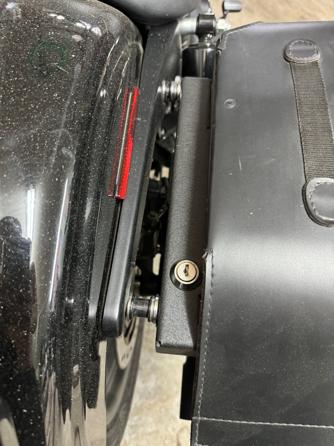

Check out pics below… These are Viking Bags with Great Bike Gear quick release mounts. If I recall correctly, and this was many years back now… I had to drill a new hole in the steel mounts so I could make them work with the shock cut-out bags. But once I did that the rest was cake. Please disregard the dirtiness of the bike - she's been in the garage all winter long and hasn't been given her springtime bath yet
You can see how the mount juts out over the cutout. You would think this would be a problem, but it’s very unnoticeable when mounted.
These are the stainless steel bolts that the mounts slide onto and lock.
You can see the gap here. This is quite honestly the worst part. But again, it looks WAYYY worse up close than it actually is. Out and about, hardly noticeable. Not to mention, these mounting bolts also facilitate a quick-release Sissy Bar from Harley, so when that is mounted, you literally see no gap at all.
