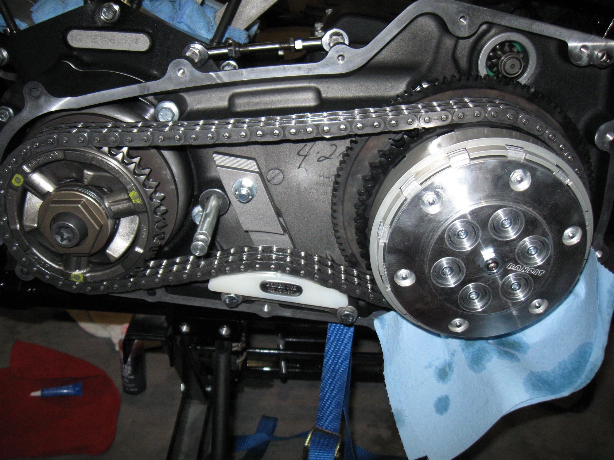

You need a strong clutch, strong. I put in a Bandit clutch and Evolution Industries clutch basket when I built my motor, it can easily handle my power and I sleep easy at night knowing it. But I've seen folks using a much less expensive system in the "AIM" clutch: https://www.fuelmotousa.com/i-208592...re-clutch.html

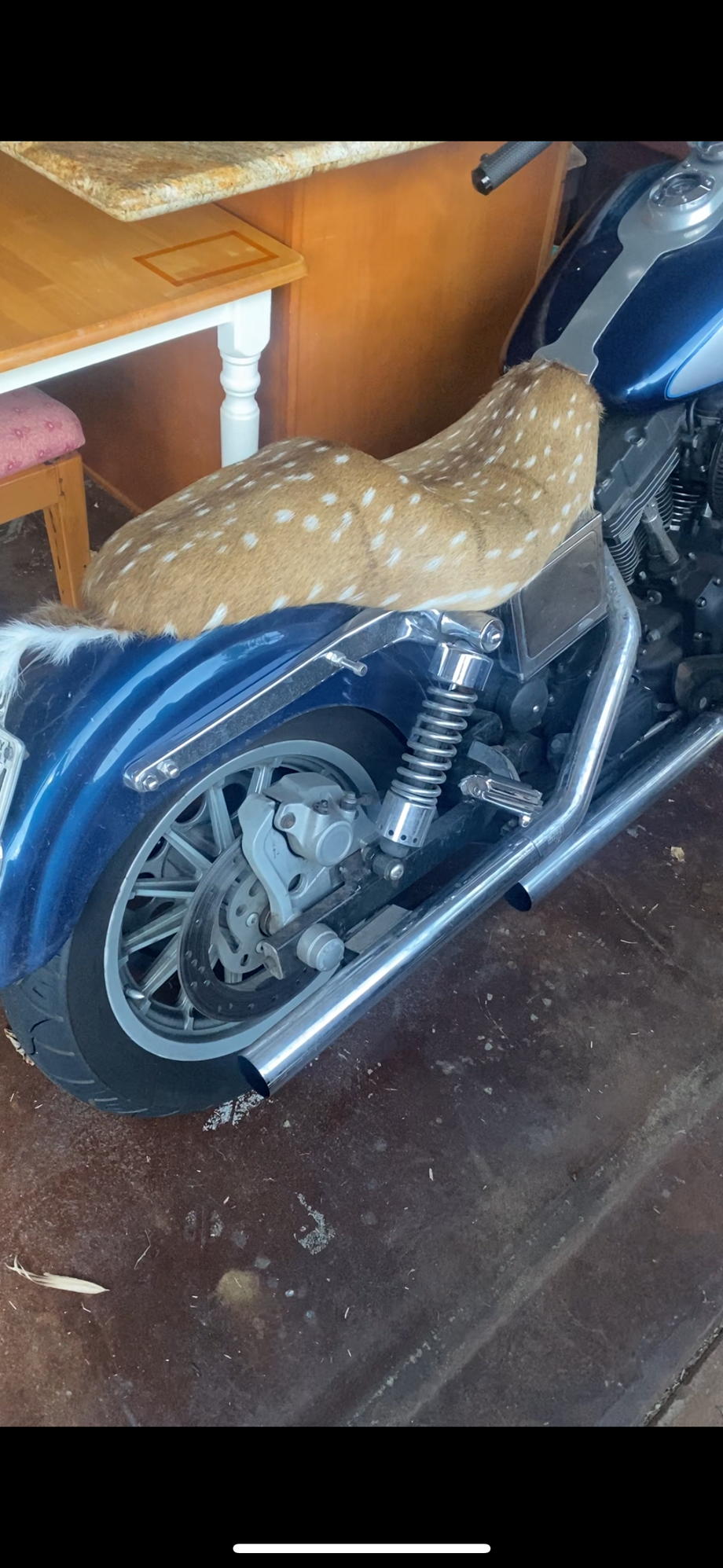

brah you are the man! Thanks for have a great attitude and sending some knowledge my way. I’ll look into the brands u suggested. As for the pictures, here ya go:
I’m a boat captain and I bring boats inter-island a few times a year. Sometimes I bring my bike w me. Either use the fish crane on the loading dock, or the fork truck if we’re on the hard.
I have a deer hide seat with the tail I made 😂. No, it’s not a Bambi. It’s an axis deer. They stay spotted their whole life. No seasons, no tags, no limits here on Maui.

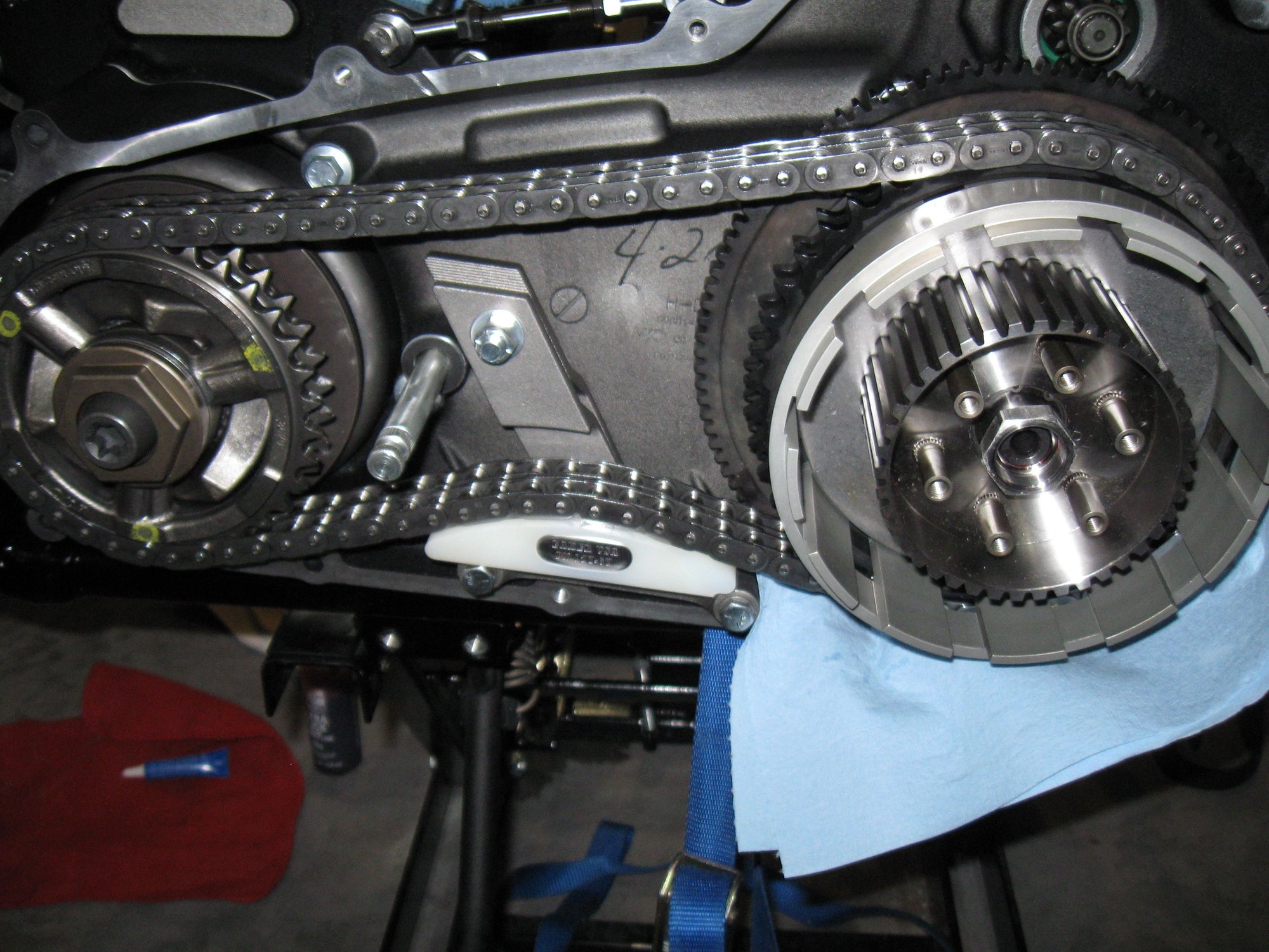

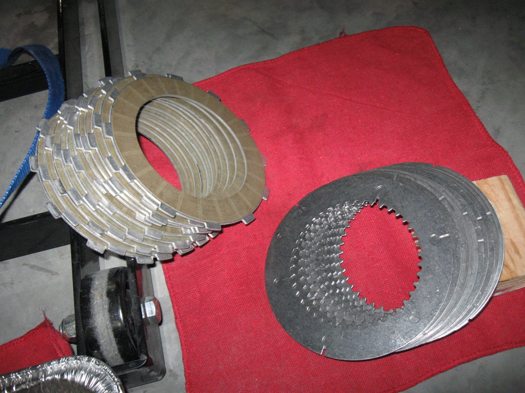

Here's some pics of my clutch, comes with three sets of springs depending on how much power you're putting to it. Also, more clutch surface than OEM, it grabs like nothing else, it'll make all other parts on your bike the weakest-links!
