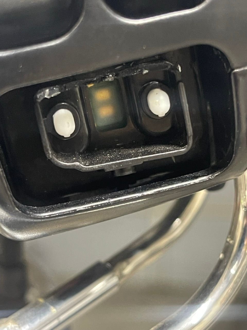

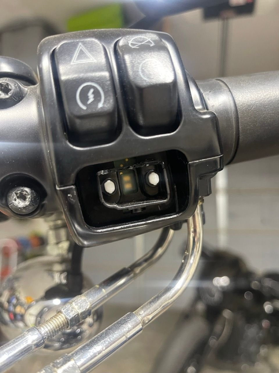

Hey all
I have a 2016 Dyna Street Bob where the piece that connects to the turn signal switch has broken. I cannot replace this piece as it is a part of the hand control itself.
I have searched far and wide and cannot find a right hand control for a 2016 Dyna Street Bob. Ive checked eBay, etc.
Any idea how to fix this? I have tried super glue (Comes right off). I even made up my own connector, but a gain nothing to attach to inside other than glue.
Any ideas are appreciated or if anyone knows where I can find a right hand control!
Thanks

You might be able to buy just the switch cap for the turn signal. I can't tell fron the pictures if anything else is damaged,
This link is for the parts catalog for your bike and it looks like #30 71500300 KEY CAP, right turn (FXDBP 103-DRAG BAR, MINI APE AND PULL BACK OPTIONS) would be what you're looking for.
99439-16B_486186_en_US - 2016 HARLEY-DAVIDSONŽ PARTS CATALOG: DYNA MODELS | Harley-Davidson SIP
This video shows how to change the switch caps. And yes I know that you are not looking for chrome. Good luck.

Thanks sir. But I have that piece the broken part is where the cap attaches to. It’s broken off the top in the photo. (Hard to see)
so the caps I have but nothing to attach to on top.

Thanks UltraGuy. Unfortunately no luck with Fallen Cycles for the part. Finding this appears to be a lost cause which means I will just have to find a glue that sticks to the piece inside.
