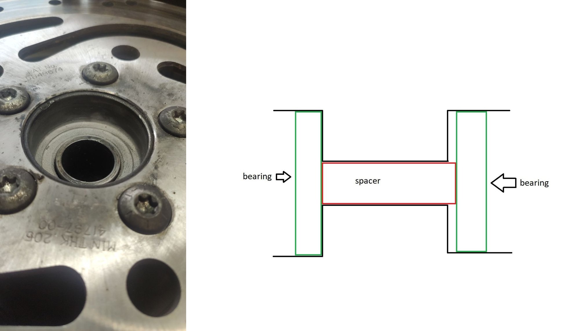

Hi all! A month ago i found a problem with my Dyna Fat Bob (2008 FXDF), at 70 mph rear wheel starts wobbling.
In winter, i disassembled bike for repainting and to replace some parts. What i replaced:
- Engine mouns.
- Fork oil.
- Tires (with balancing).
- Wheel bearings.
- Install chain conversion kit.
- And a lot more, but I don't think that's relevant to the problem.
After that there were problems with wobbling, it's hard to say what caused the problem, since a lot has been done and replaced. What have i done to try to fix the problem:
- Replaced swingarm bearing and bushing. Now the wobbling starts at 80 mph.
- Replaced neck bearings.
- Replaced rear shocks.
- Checked brake disks (rear <-> front) aligment, ~1 degree diffrence all OK. (Hmm... Maybe check the stabilizer link???)
- The rear axle is adjusted correctly, checked many times.
When i changed the bearings in the rear wheel, i noticed that the spacer is longer than the wheel hub (see spoiler), this does not allow the bearing to be completely inserted. Is this normal? Maybe the spacer was replaced by the previous owner from another bike?
Spoiler
Maybe someone has an idea what can be done or checked. Thanks for the help.

Saw the pic.. Looks like a 2007 or earlier wheel and the spacer for the wider bearings.. Time to call in @multihdrdr

From the pic you attached, the sleeve looks proud in the rotor side of the rear wheel. That, in my experience is wrong. Like mentioned, you usually install the brake rotor side bearing first, making the sleeve slightly proud on the pulley side of the rear wheel. I would need to read the service manual for your specific year/model bike to confirm this...
The bearings are installed correctly following the manual. In the picture on the reverse side there is no bearing at all, i put a metal circle almost the size of a bearing to make sure that the spacer is larger than required. I think that the long spacer is the problem, the bearings are pressed against the inner ring, while nothing prevents the hub from moving along the outer ring (bearings are installed tightly, but not enough to fix the wheel otherwise we would not have been able to pull them out at all), especially at high speeds and turns.
Spoiler
I think that the spacer should be shortened, but I'm not sure that it will be correct.

The right bushing in the swingarm fit.. They seem to have too much play when new in come cases.. I'd set it up with 0.002 clearance. Left side is spherical, IIRC and should be reasonably tight..
The bushing has been replaced. But the gap between the axle and the spacers seemed too big to me. Anyway, after installing swingarm, i checked it for horizontal movement and found nothing.
Vertical alignment. Make sure the disks are in the same plain.. Need levels to check. You say 89.3 versus 90? Get them close to perfect.
I will try to achieve 90 degrees, but i don't think that ~0.7 degrees will solve the problem.
What rear shocks did you use?
Stock from another Fat Bob.
You can try try to play with steering bearing preload.
I will try to tighten the bearings more tightly, but the wobbling is almost not felt from the front, i think that everything is fine with them.
It seems to me that the spacer is from another wheel.

lastly I would try another complete rear wheel,. At those speed its a resonance thing, so once the front and rear aligned, you need to check the rear wheel itself, as you have done all the needed in terms of bushing and stabilisers etc.
Spoiler
That is fine.. It's the way they are set up from the factory. They rely on press fit to control axial play.. If they bearing are loose you got problems..
