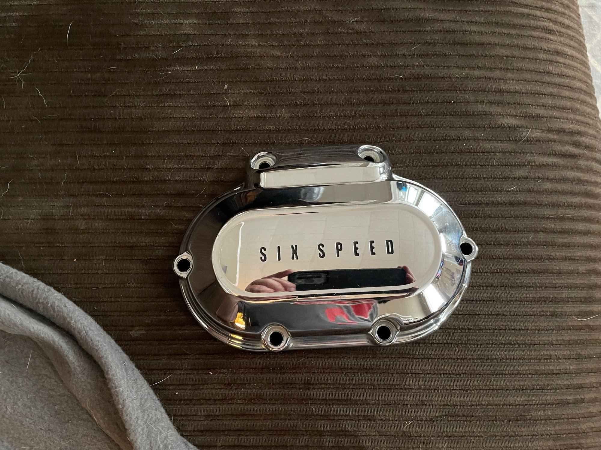

How hard is it to replace this? Do I need to drain the fluid first?

You either drain the fluid or lay the bike on it's left side, or the transmission fluid will be dumping out when you remove the cover.

I drove mine up on about 2ea 2"x6" and carefully leaned it over nice and easy on the kickstand and the angle keeps most of the fluid below the lowest point of the cover line.
I'd put it up and let it sit long as you can so most shifts to the downside and you should be pretty good, might be a little dribble but nothing major. One 2"x6" isn't enough, three inches may do it but might get a touch more dribble.
Mind you now, I take no blame for anything but if I can do it anyone can

Drain the fluid and replace it, you know it's due.
Also a new o-ring for the cable. 11179 - O-RING

naaa—you lose a tiny bit—I’ve changed em for looks, taken em off for new clutch cables, the kickstand lean is plenty.

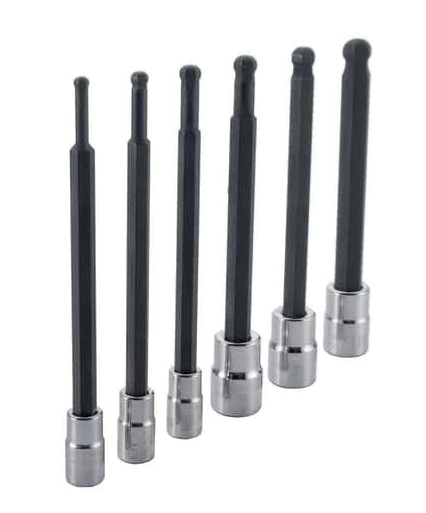

One assumes you will need to remove the exhaust
Penetrating oil on the exhaust flange bolts for OFF, anti-seize for ON
Obtain new exhaust gaskets

It always amaze me what some will do to save 10 bucks. Just drain the oil out and replace it when finished. You may have to loosen the rear exhaust to get the cover off.

stock headers? A ball hex is all you need. You don’t even need to remove the heat shield. Works with the torque wrench. Not sure why everyone is trying to make more work for this guy.

[QUOTE=fskitch;21720098]stock headers? A ball hex is all you need. You don’t even need to remove the heat shield. Works with the torque wrench. Not sure why everyone is trying to make more work for this guy.
I said "assume" because we have no idea what bike or what exhaust
