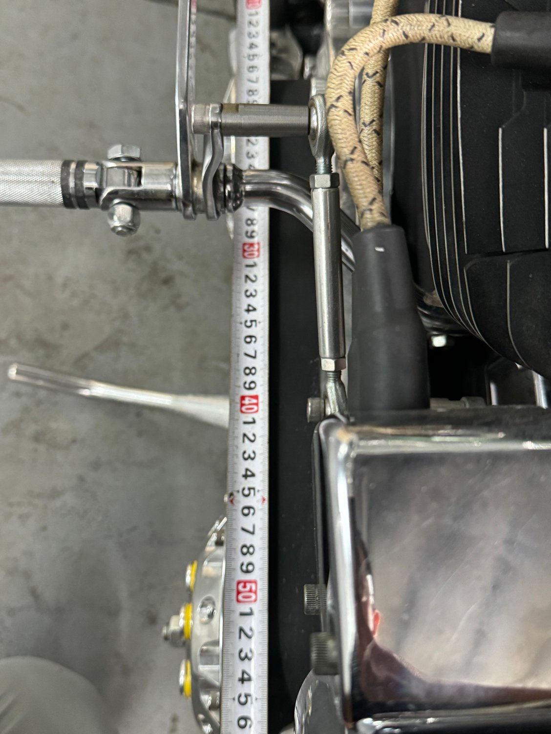

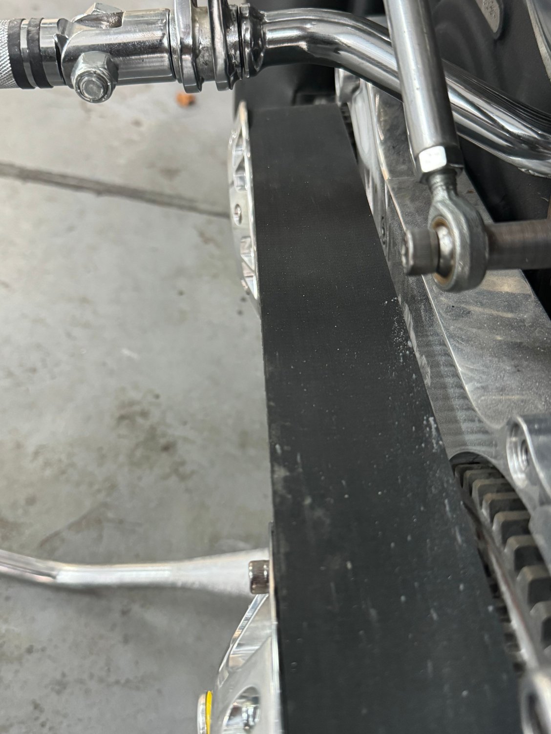

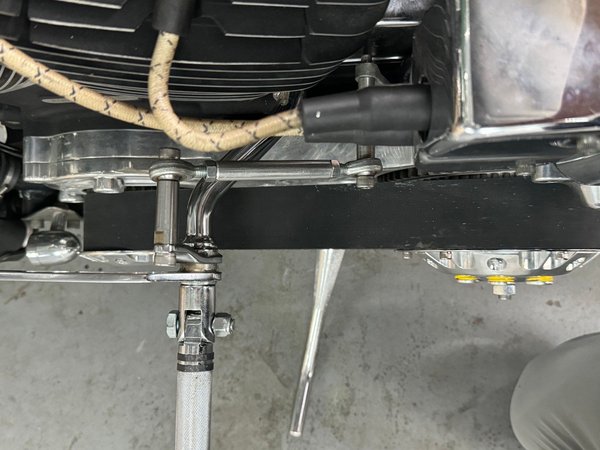

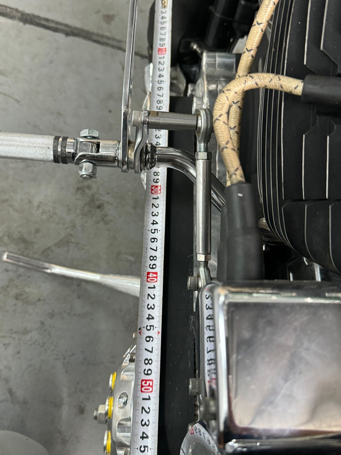

If the belt is so wide that there isn't clearance on at least one side, that may be the source of your noise.. If you want to check alignment should be able to place a straight edge across the outside edge of the pulleys. They should be flat..
I suspect the belt is too wide for the pulley and you may want to refer to the instructions or contact ultima.
I took some pictures. Its the 2” belt kit come all together

Update: After some trips arround the country, the noise is still there.
Do a quick research there are 2 over teeth belt that I think it could work:
1. BDL-141: 141T (over 1T) 8mm but only 1 3/4” width (compare with the stock Ultima 2”).
2. BDL-142-2: 142T (over 2T) 8mm 2” width.
I think I should give the second option a try. Just wonder over 2 teeth is normal or too much loose? (The current Ultima 140T is tight as f***)
