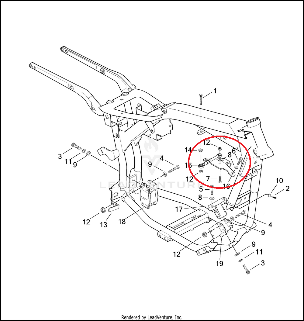

Did you do the engine alignment as specified in the H-D Service manual?
Check engine mount bracket & Stabilizer Link also.
No but I will now....thank you !!!
