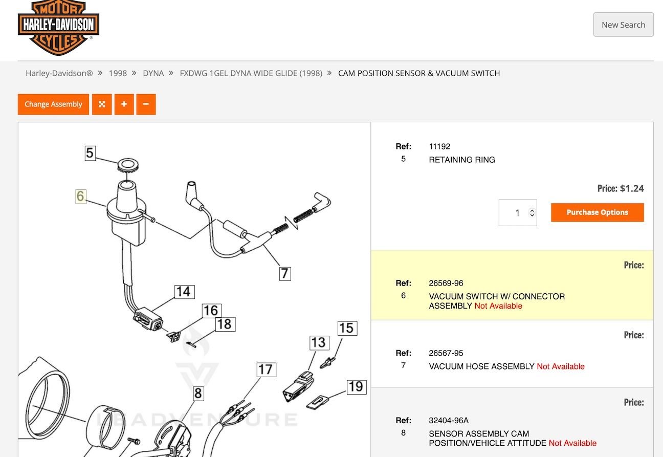

Have you checked the VOES ..... ? It's #6 below.
And maybe #7, the vacuum lines to the VOES.
don't have a VOES. it it ran fine with out one for some time then all of the sudden started getting these problems.
