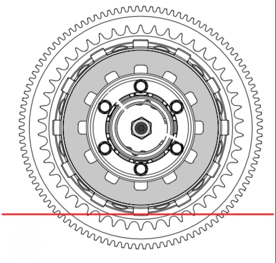

great. should I pour oil into the primary in this position of the motorcycle?
Old Oct 1, 2024 | 08:20 AM
  #44
Olegpeg's Avatar
Olegpeg
Joined: Aug 2024
Posts: 22
From: Saint-Petersburg
fill it up until it starts to flow?
I believe you're supposed to have it standing upright. I use a block of wood under the kickstand to make it level when I fill the primary on mine.

Upright.
To this level

Originally Posted by brakeless
Upright.
To this level
It's 1 quart in the primary for a 97 & 98 WG, per the Manual.

When it comes to filling a primary, forget how many ounces the manual says, too many of them are incorrect.
The proper level is when the lube just touches the outer diameter of the outer clutch shell, just like the illustration (bike standing up vertical).
This level is correct for all OEM clutches since mid 1984.
